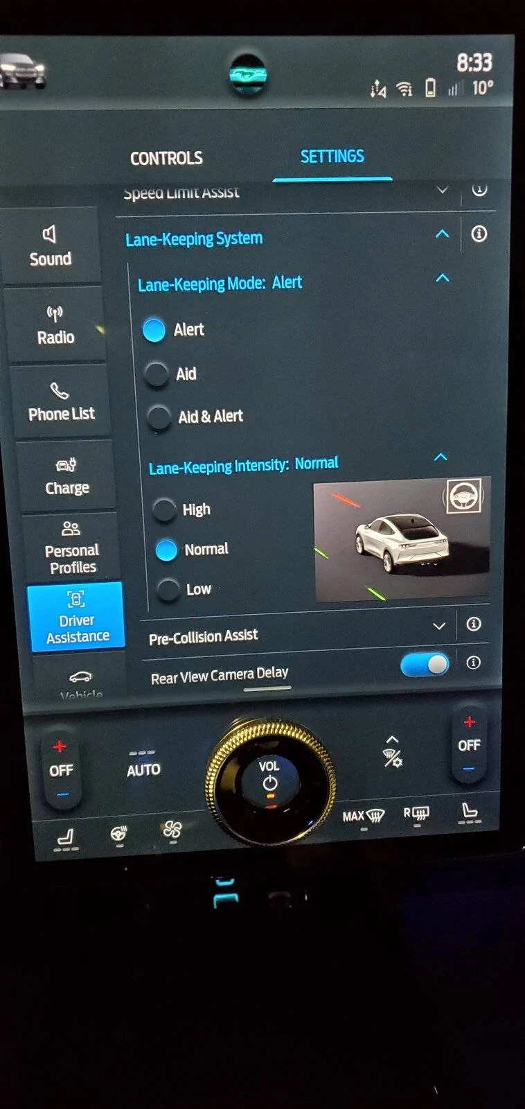

Ok here's how your get the speed to show up in the center of the display
1. Goto Driver Assistance
2. Turn off Distance indication under "Pre- Collision Assist"
3. Make sure Lane-Keeping System is off by pressing hard button on left of steering wheel
Ford Mustang Mach-E Speedometer Display Pre-collision
Ford Mustang Mach-E Speedometer Display lan
Ford Mustang Mach-E Speedometer Display speed

The other day I had it switch to the centre screen and used it all the way home after I turned off lane keeping.
Now I can't make it go back to the centre even when i try, there's no distance indicator option anymore. Even tried turning on standard cruise control
