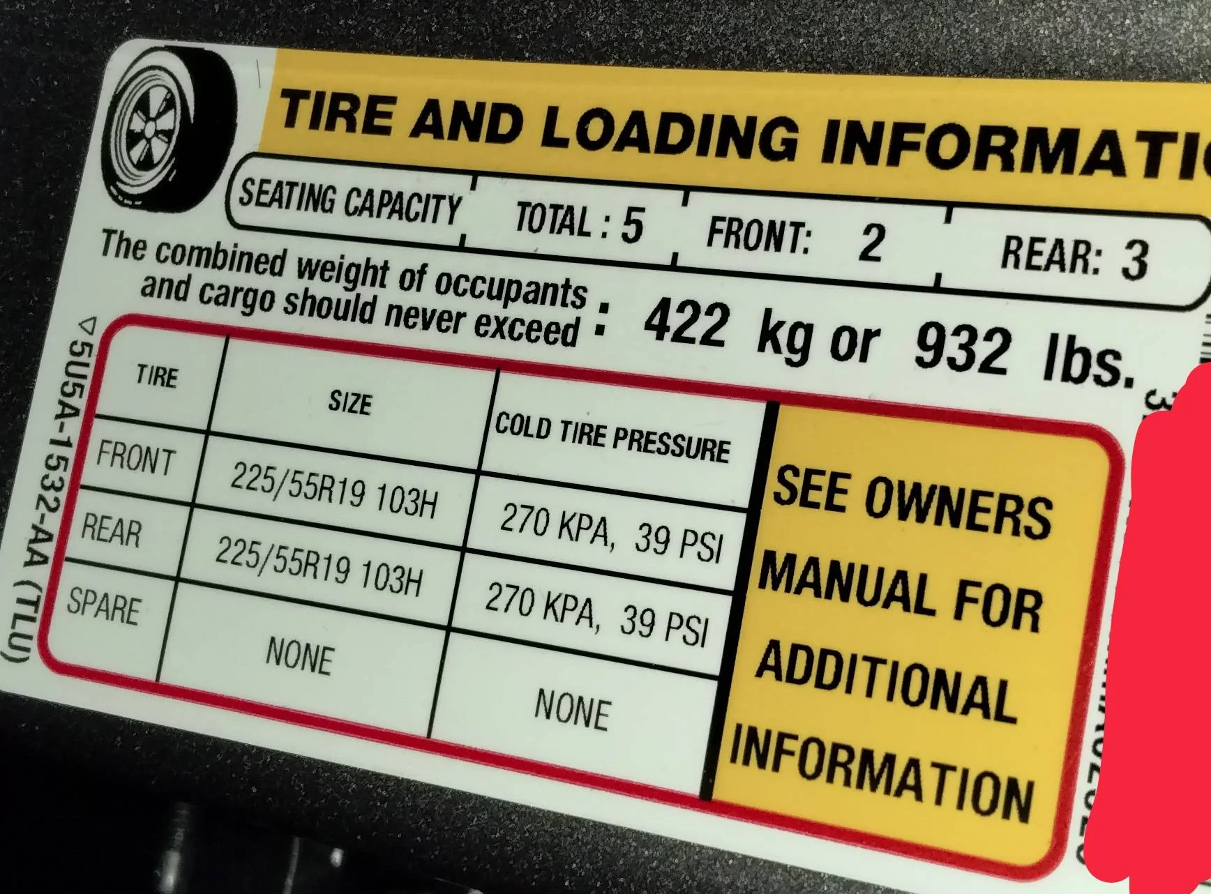

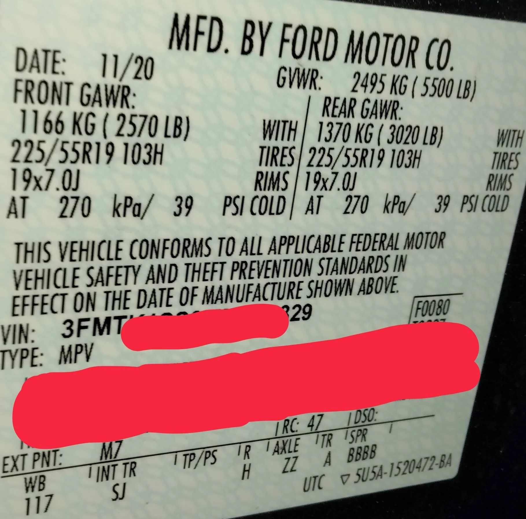

New: 24 GT w/ perf. upgrade Vapor Blue // Old: 22 GTPE DMG // 21 Select CG
Year: 2021
Trim: Select (19" Wheels)
Drive: AWD
Battery: Standard
GVWR: 5500 LB
GAWR (Front): 2570 LB
GAWR (Rear): 3020 LB
Maximum combined weight of occupants and cargo: 932LB
Ford Mustang Mach-E Please post your vehicle weight information! IMG_20220222_204747__01
Ford Mustang Mach-E Please post your vehicle weight information! IMG_20220222_204731__01

Year: 2021
Drive: AWD
Battery: Standard
GVWR: 5500 LB
Thank you!
