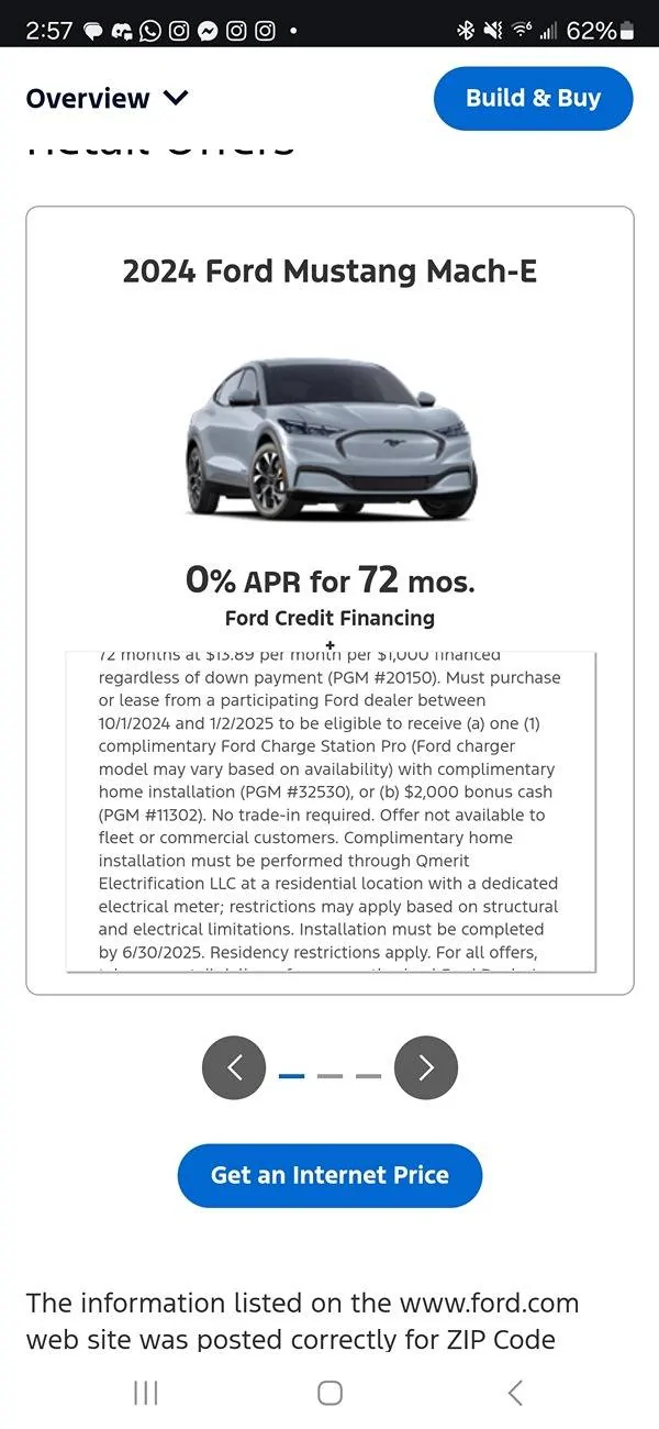

This is showing 2k in bonus cash if you opt out of the complimentary charger.
Yes, they offer bonus cash for the EVSE delete, but you will likely shell out more than that to buy a comparable unit and have it installed, unless you are in good with an licensed electrician. ??

I'd check with an electrician with EV experience to see what they charge. Install of the nema 14-50 only cost me around $350 but my garage was new with the box right there and they only ran a very short line from the box to the plug. Also, check with your local utility to see if they offer any evses (chargers) at a discount.
I agree with this. My install was $200 for the electrician, but my charger is right next to the panel. $600 for the charger, taking the $2k obviously would have been a better deal.

Mine was probably half that $2000 for the charger and the install combined. Though a lot of it may come down to how much copper/cable you need to run to where your charger will be located. I also got my charger on sale (I think it was $400 for the Chargepoint at the time) and just needed the outlet.
