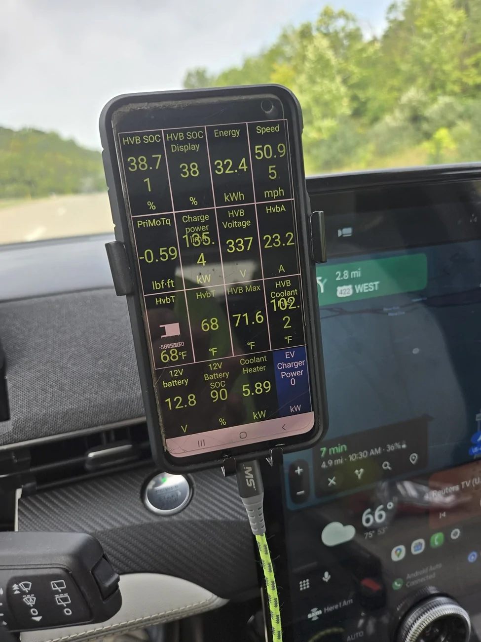

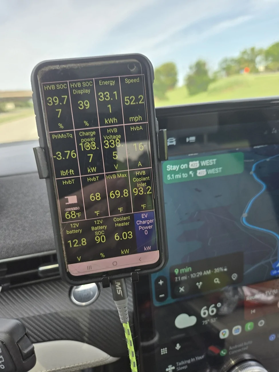

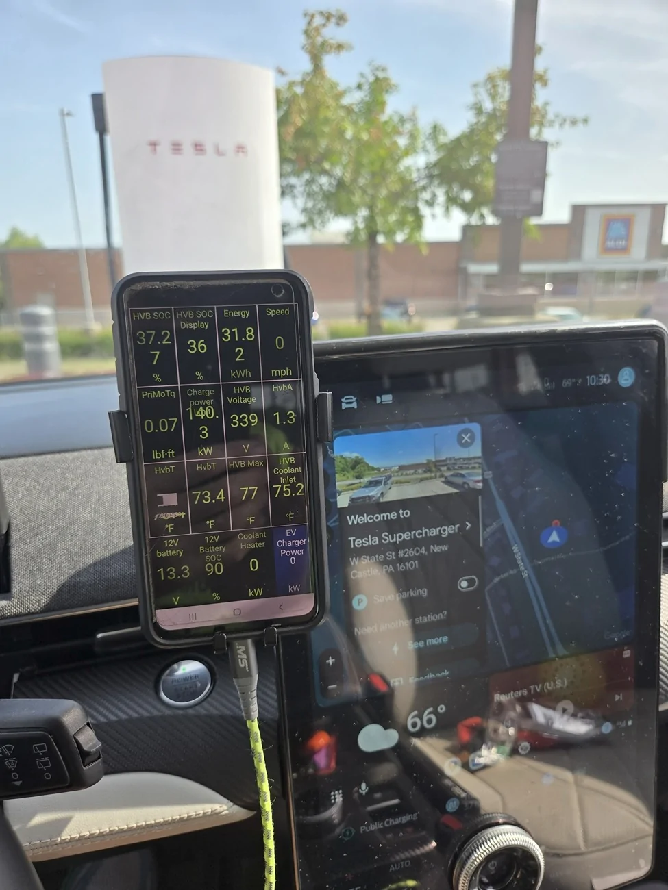

Seen today, identified a Tesla SuperCharger location in Android Auto. Car began warming the battery pack (temperature) and then 4 miles from the charging station, it stopped warming the battery pack at 73 or 74f. Struggling to transfer photos from my photo. Walmart here we come for prints.
Ford Mustang Mach-E Pre-conditioning up to a certain (74f?) HVB battery temperature pre condintioning at 68f
Ford Mustang Mach-E Pre-conditioning up to a certain (74f?) HVB battery temperature preonditioning at 102f
Ford Mustang Mach-E Pre-conditioning up to a certain (74f?) HVB battery temperature pre conditioning at the tesla station with zer0 heat
11,366
25,033
Yes, the target battery preconditioning temperature is 23ºC or 73ºF. The heater will turn off when that temperature is reached, and the circulation pump will continue to run. The heater will cycle back on again if the battery temp drops below about 20ºC.
Other manufacturers use a higher target temp of 30ºC+ to support high amperage charging, but since the Mach-E does not DC charge at a very high C rate, it may be pointless to go warmer.
