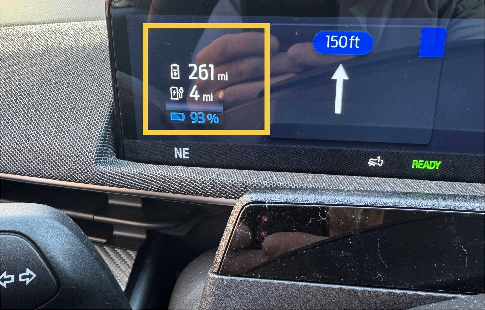

Yes, can use built in nav or Google maps through Android auto. Android auto is the only way to get preconditioning to work to a NACS Supercharger since they aren't in the Nav database yet.
Preconditioning is active while less than 18.6 miles from the charger (not the other way around).

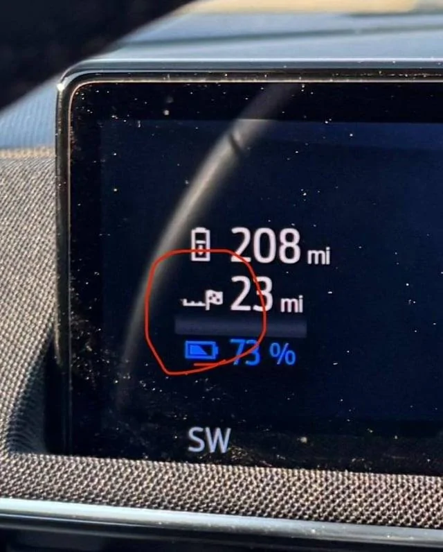

I just tried every combination on iOS and none put the charger icon on the SOC display to designate preconditioning, only destination flag.
On iOS tried Waze, google maps, Apple Maps. I don’t have androind phone to try.
Separately, public charging app doesn’t either. Only searching for chargers in the ford navigation app will start preconditioning, again from what I understand about the charger icon.
Location has to be a charger the ford navigation app knows. Tired putting in Tesla supercharger and it only set as destination, not charger.

Nope, if you use the public charging app it won't precondition. The icon in the cluster for distance has to be a charger or preconditioning won't work. If it's a flag, then it won't do anything. The only way to navigate to a NACS supercharger and get preconditioning is through Android Auto/Google Maps. Nothing else works right now. This is why we've been begging for them to add the NACS Superchargers to the NAV for the past year so we can use preconditioning.

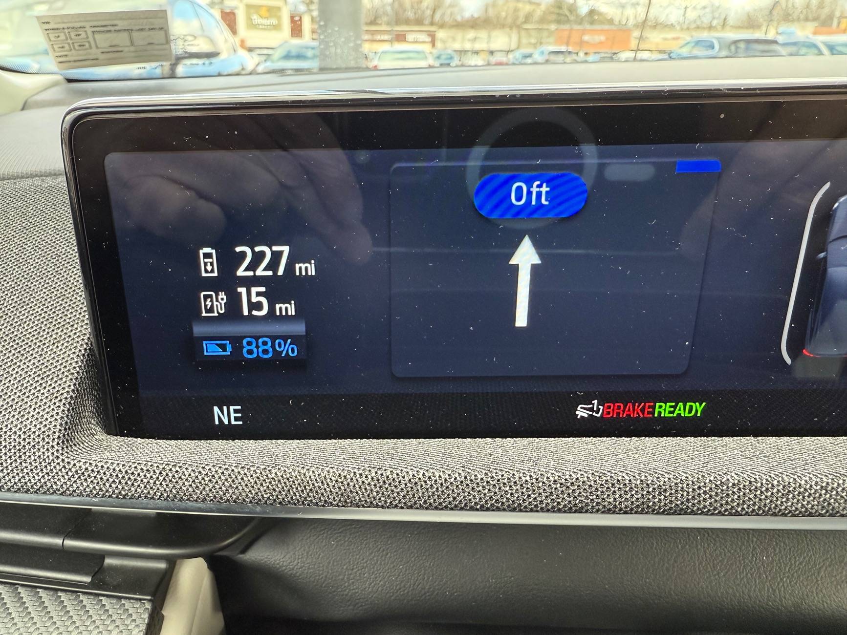

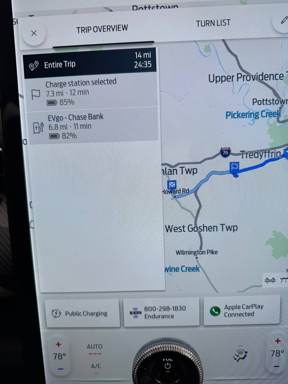

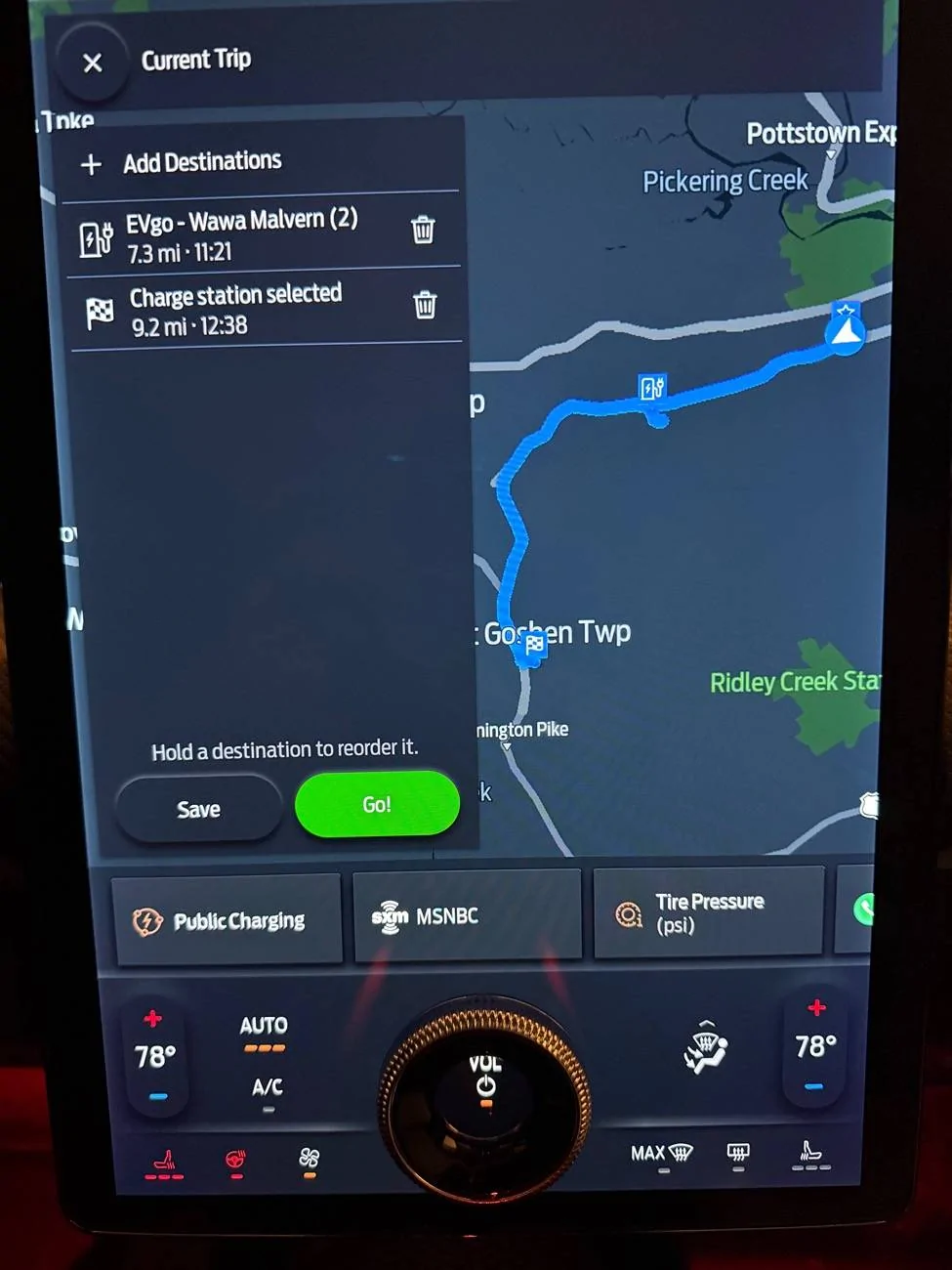

First, I want to thank @Mach-Lee again for sharing all of this information, and for putting up with my many repetitive (and likely stupid) questions!
I absolutely understand that there is NO way, using only software native to Sync 4 (Connected Navigation and Public Charging) to select a Tesla SuperCharger as a destination AND have the car pre-condition en-route to it.
However, I wanted to try to see if there might be some kind of workaround that would provide SOME level of pre-conditioning before arriving at a Tesla SuperCharger.
The first case, is also the most trivial. About 5 miles from my house, in Malvern, PA, there is a Wawa (a convenience store) that has BOTH EVgo and Tesla SuperChargers. If you want to pre-condition before getting there, you can select the EVgo charger as a destination in Connected Navigation, then use one of the Tesla SuperChargers when you arrive. But, there likely aren't TOO many co-located Level 3 CCS and Tesla SuperChargers.
Two non-trivial cases:
Case 1 - Level 3 CCS Charger en-route to a Tesla SuperCharger:
  • Assume a route where there is a Level 3 CCS charger on your way to the Tesla SuperCharger you want to use (it may not be directly on the route, but somewhat en-route).
  • Use Connected Navigation to select that Level 3 CCS charger as a destination.
  • Go into Public Charging, select the Tesla SuperCharger you really want to go to, and then, in Connected Navigation, add that as a waypoint.
As you can see from the pictures below, I get the pre-conditioning icon on the instrument panel, with the distance to the Level 3 CCS Charger. Obviously, once I'm past that CCS charger, my car will no longer be pre-conditioning, and any pre-conditioning that was done will slowly degrade. I understand that.
Ford Mustang Mach-E How can I know my HVB is pre-conditioning? IMG_2476
Ford Mustang Mach-E How can I know my HVB is pre-conditioning? IMG_2477

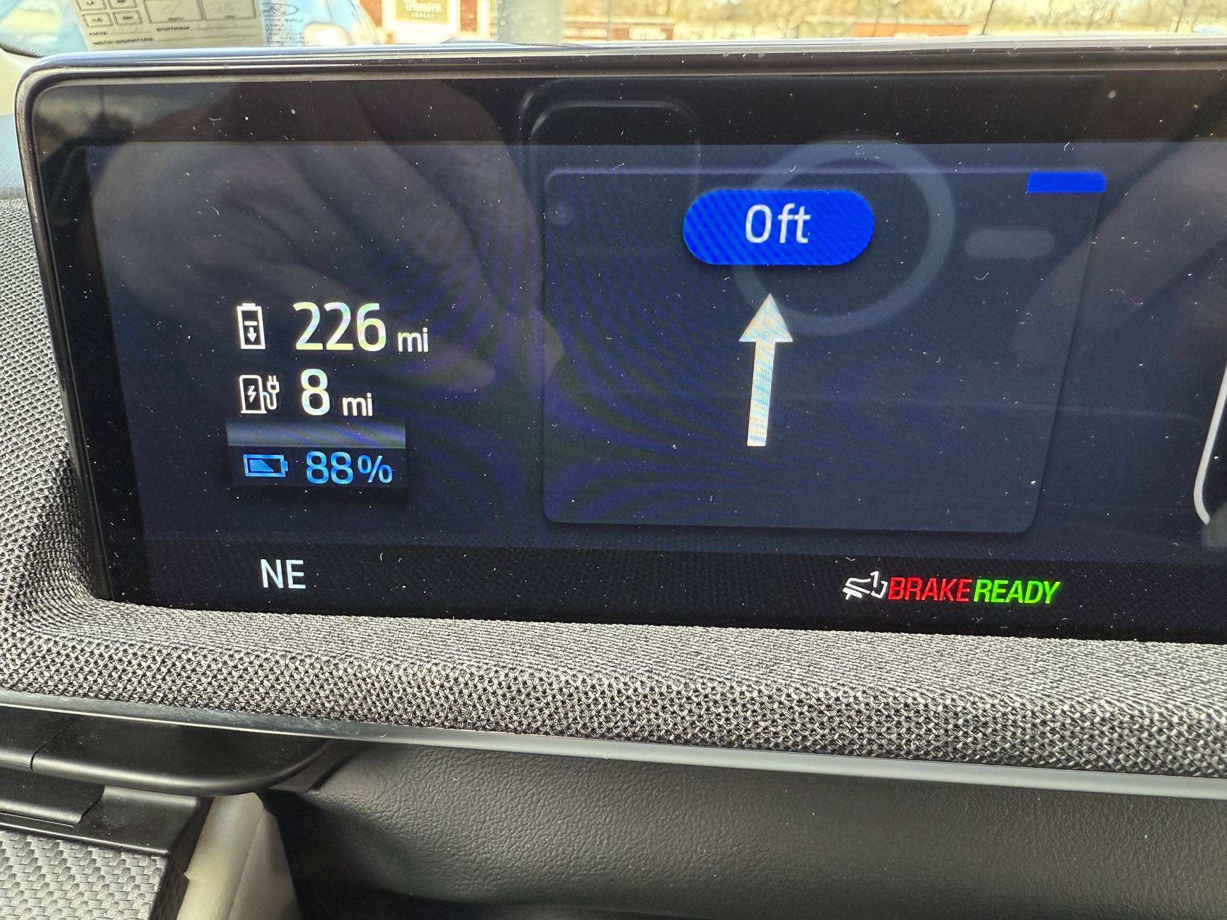

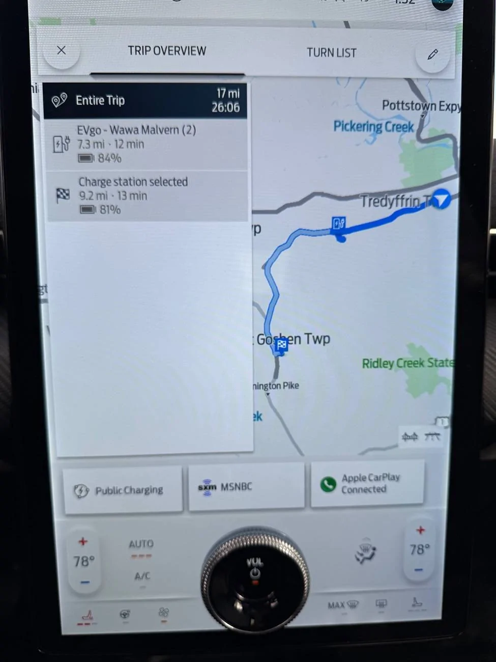

Case 2 - Level 3 CCS Charger beyond a Tesla SuperCharger:
  • Assume a route where there is a Level 3 CCS charger after Tesla SuperCharger you want to use (it may not be directly on the route, but somewhat en-route).
Again, as you can see from the pictures below, I get the pre-conditioning icon on the instrument panel, with the distance to the Level 3 CCS Charger. Now, it's possible/likely that the pre-conditioning won't be complete before I arrive at the Tesla SuperCharger, but at least some degree of pre-conditioning should be done.
Ford Mustang Mach-E How can I know my HVB is pre-conditioning? IMG_2474
Ford Mustang Mach-E How can I know my HVB is pre-conditioning? IMG_2475
Conclusion:
Obviously, the "correct" answer is for Ford to add Tesla SuperChargers to Connected Navigation. Problem solved and no Android Auto/Google Maps necessary.
The closer the Level 3 CCS charger used as a "pre-conditioning dummy" and the Tesla SuperCharger are to each other, the more effective this solution will be.
It does appear to offer a workaround for now. I'd be interested in hearing about any flaws in my methodology that would make this solution unviable.
