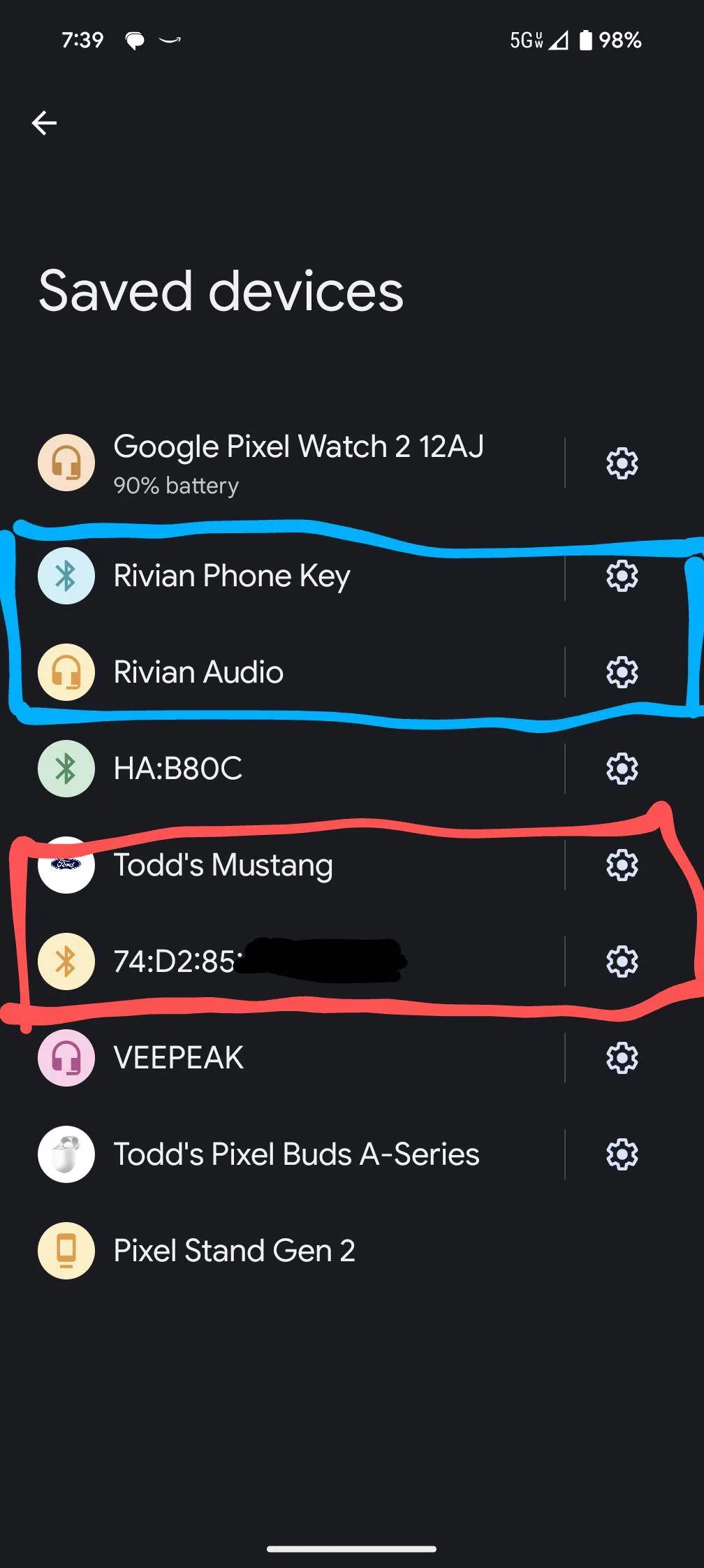

Does the Rivian also have 2 BT connections to the car?
There's an audio and a PaaK bond, which is the same as the MME. The double pop-up on the MME doesn't create 2 connections, it's 2 acknowledgements for the same connection. Blue is Rivian, red is the MME.
