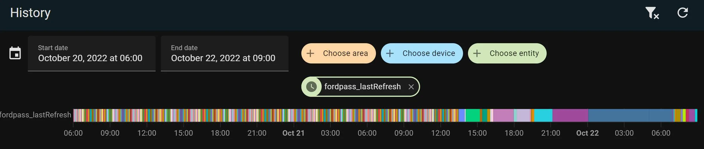

National Grid? I emailed the app developer from within the app and they disabled the data connection within hours. They were refreshing every five minutes - I could see where the refresh demand ended. It still took ford about four days to let me out me out of the sin bin.

Well let's just say that I am not asking Ford that question. They homed in on the ChargeSmart and I did what they asked.
But that gave me a good view of what ChargeSmart was asking of the API and car.
The FordPass Integration only demands a refresh when the service fordpass.refresh_status is called by an automation. Otherwise it "seems" to just be reading the data.
