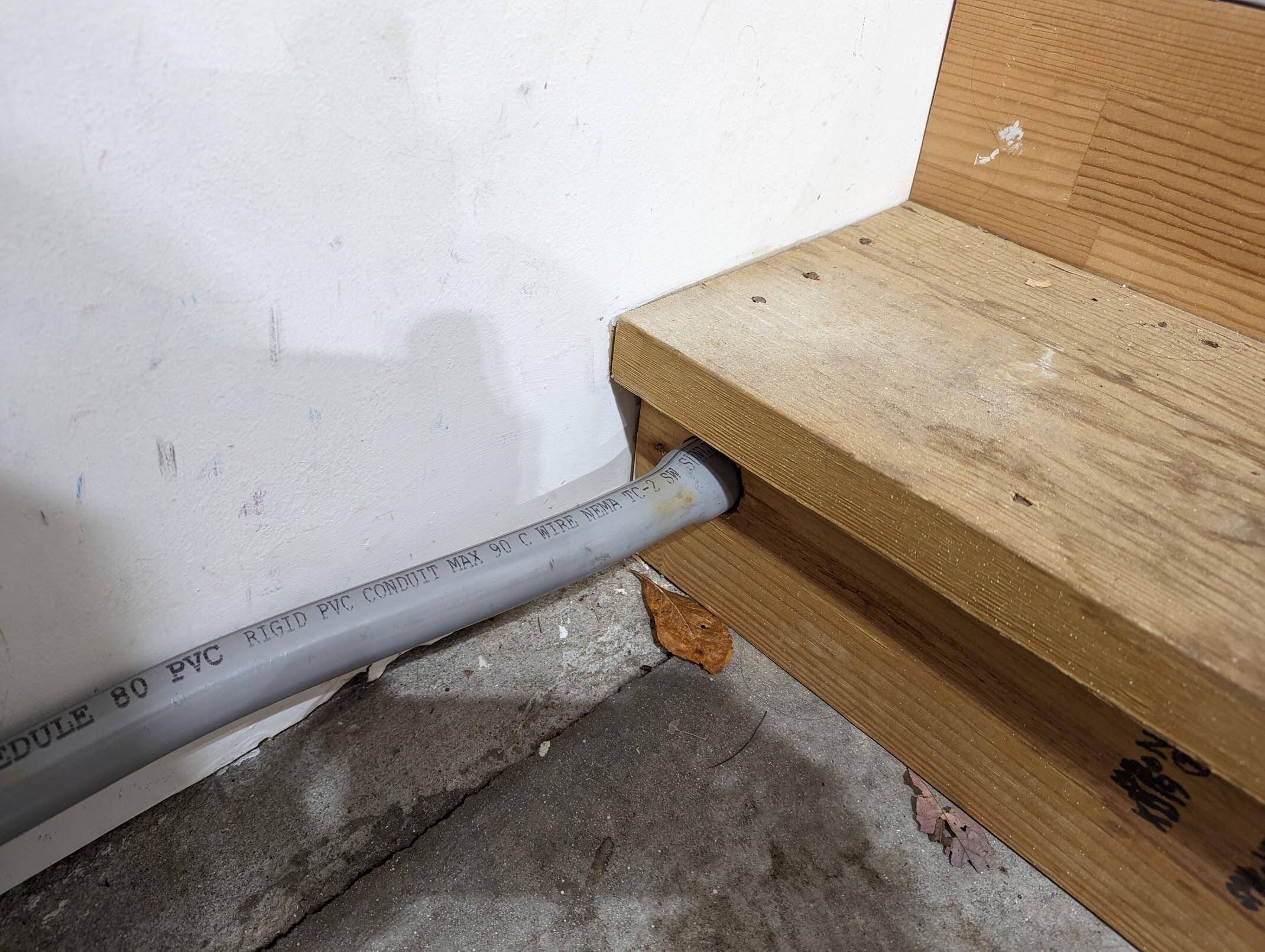

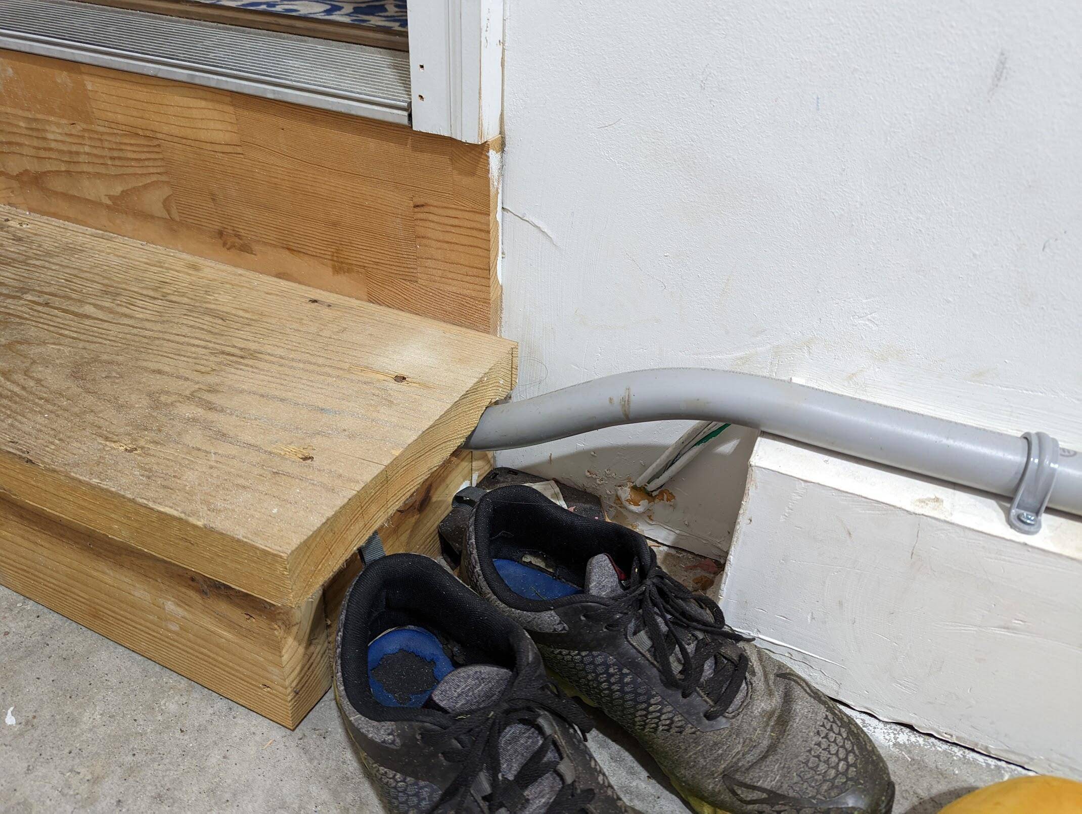

I did my own install from the panel to the garage; about a 50ft run in a townhouse (back to front). Albeit I chose to do a hardwired installation for my ChargePoint Home Flex EVSE, everything will be the same for you up until the 14-50 outlet. Below are my recommendations:
  • Use PVC conduit; I specifically recommend the flexible liquidtight/liquidtuff PVC conduit
  • Verify with your local building code whether a regular or GFCI outlet is required; usually is GFCI-required
  • HIGHLY recommended to use stranded THHN in conduit; much easier to deal with
  • SUPER HIGHLY recommend to get an industrial 14-50 outlet; get a Bryant NEMA 14-50 from Grainger (Bryant is a sub-brand of Hubbell)
