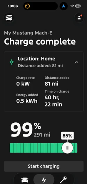

I regularly charge to 85% overnight. (Ford supplied charger @ 110v/1.2Kw. Only occasionally use 220v). Never had a problem until last night... I parked, plugged in the charger, left the setting on its usual 85%, but it charged to 100% (even though app shows 99, in car it was 100%) The slider clearly shows setting at 85%, yet the charger bypassed it.
Should I be doing something different? Is this just a random deviation?

Let us know if it happens again next time you charge.

Did you get an update?

Your app shows 81 miles added with only 0.5 kWh in 40 hrs and 22 min. Seems like something is really off with those stats

Hi
I read somewhere that Ford recommend You charge the battery to 100% once a month, maby it's some kind of health program that over rules Your settings if You haven't charged to 100% for a long time ?
I have a Google Pixel phone that does that, I set it to 85% but once in awhile it charge to 100% for maintaining the battery.

That is for owners of LFP batteries. Aka 2023.5+ Select and Premium Standard Range vehicles. Does not necessarily apply to NCM batteries (anything with Extended Range), though a periodic trip to 100% isn't a bad idea, it just isn't as necessary.

Sorry for the delay, I drove my other car for a few weeks. I charged a few days ago, and it stopped at 85%, so it appears, as others suggested, that it was a recalibration... artifact?
