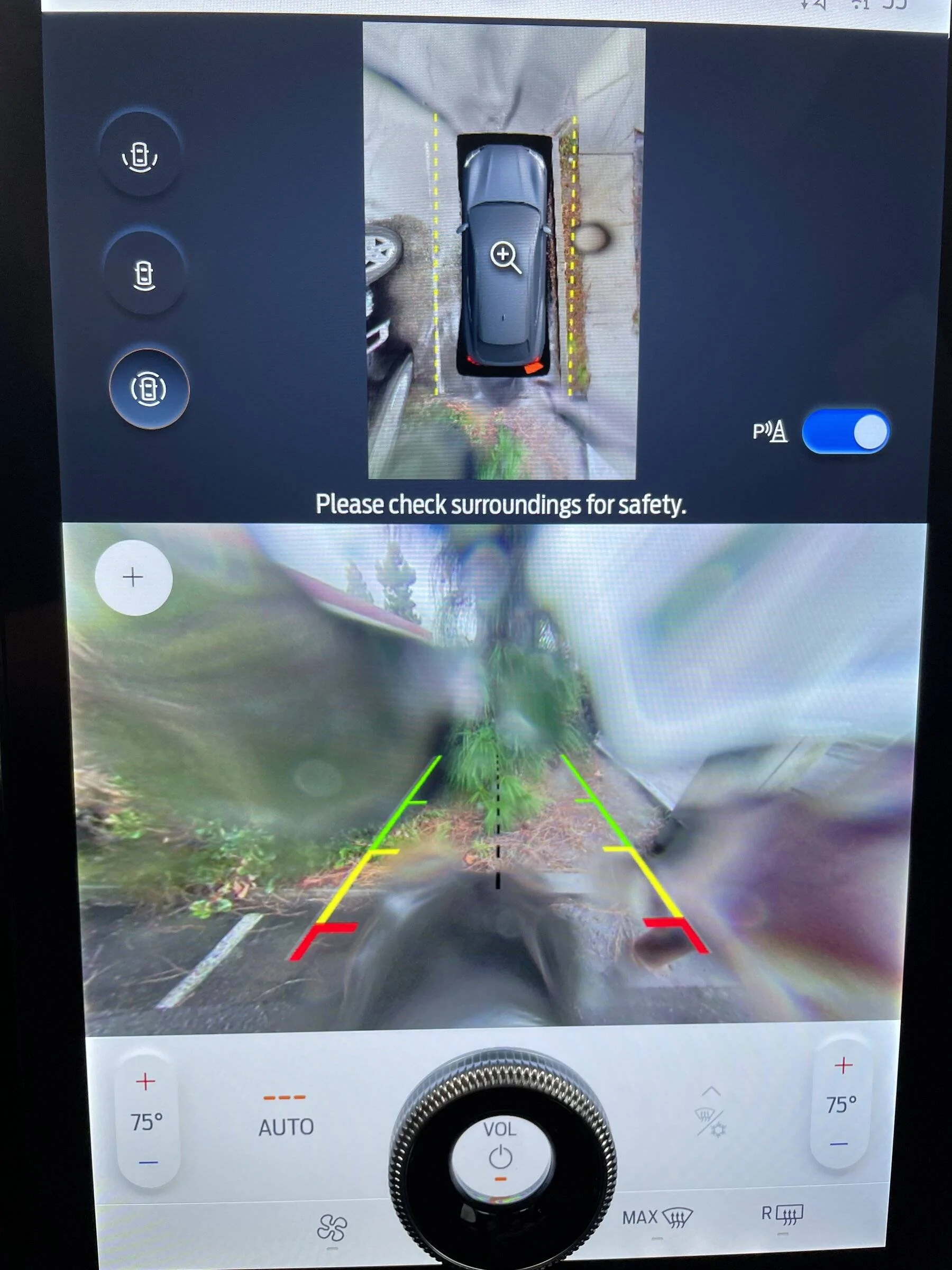

Take back what I said, the back camera is as useless as a wooden frying pan when raining.
There was a small pole back there someplace. Imagine my horror as I had to actually twist my body to look back through my back window to backup. Man... I don't think I've done that for at least 10 yrs :)
