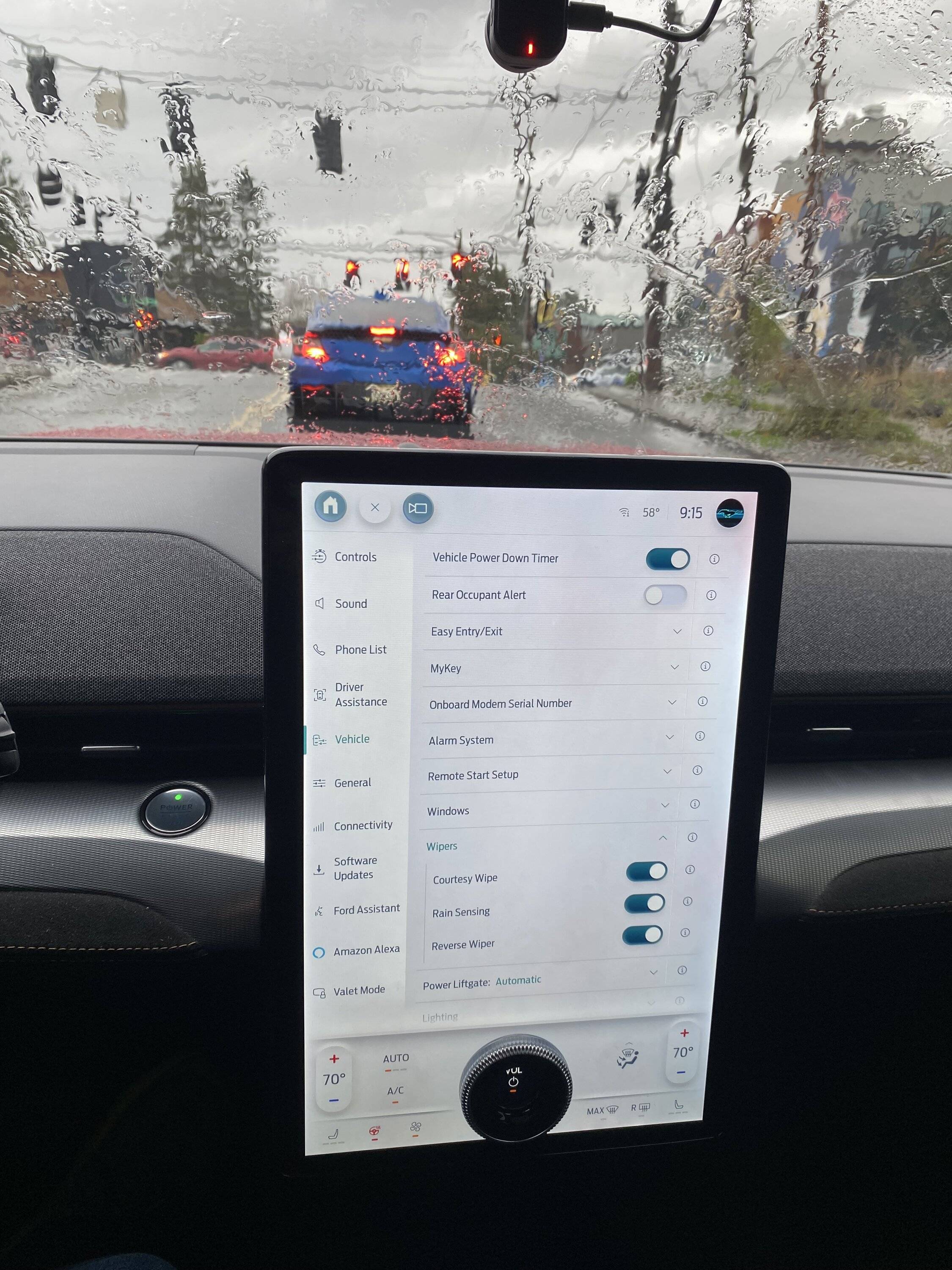

Anybody else notice their rain sensing wipers not working anymore?
Ford Mustang Mach-E Rain Sensing wipers don’t work IMG_2542
Have you had your windshield replaced recently? Any other work in the area of the rain sensor?

Mine work fine, other than an occasional swipe when it's not raining if I forgot and left them on, which happens a lot... I think they use infrared that reflects differently if there are water drops on the windshield. I am wondering if your sensor got blocked or misaligned or something, but I don't know where the sensor actually is.
Another possibility might be that it got messed up in a recent OTA update or something. I know people have had problems with losing their folding mirrors setting after an update last week. Maybe try toggling the setting off and back on and see if it makes a difference...

You still have to have your wipers "on." If the wipers are fully off, rain sensing will not work.
