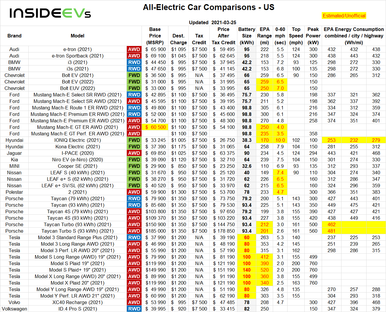

The estimated combined energy consumption quoted by Ford implies the stated battery capacity is net of any buffer (or no buffer at all). E.g. LR RWD has estimated consumption of 16.5 kWh/100km (WLTP) so 98.8/16.5 x 0.621371 x 100 = 372.07, where 0.621371 is km to miles, and estimated range of LR RWD is 370 miles (WLTP). Note these are UK specifications.
