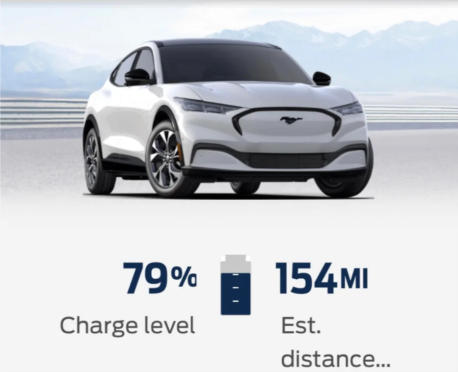

In my Premium AWD Extended range I am seeing lower than expected estimated range. I only have 100 miles on the car, do I need to clear something to get a better estimate?
Thanks,

If its been cold where you're at, that is why.
I picked mine up 2 weeks ago. It was 1F outside and at 100% charge the range meter was showing 140 miles. The car has to use energy from the battery to keep the battery warm, and keep the cabin warm.
The last 2 days we've started to warm up here and i'm already up to 200 miles on a 100% charge. So as it warms up more the range will go up as well.

Don't be surprised if they don't come up right away. I think the only way to get it to jump up would be to reset your driving history again once you're in warm temps. Mine has slowly been creeping up over the last 4 days. Every time I take it out and drive, and then re-charge it shows a higher range.
