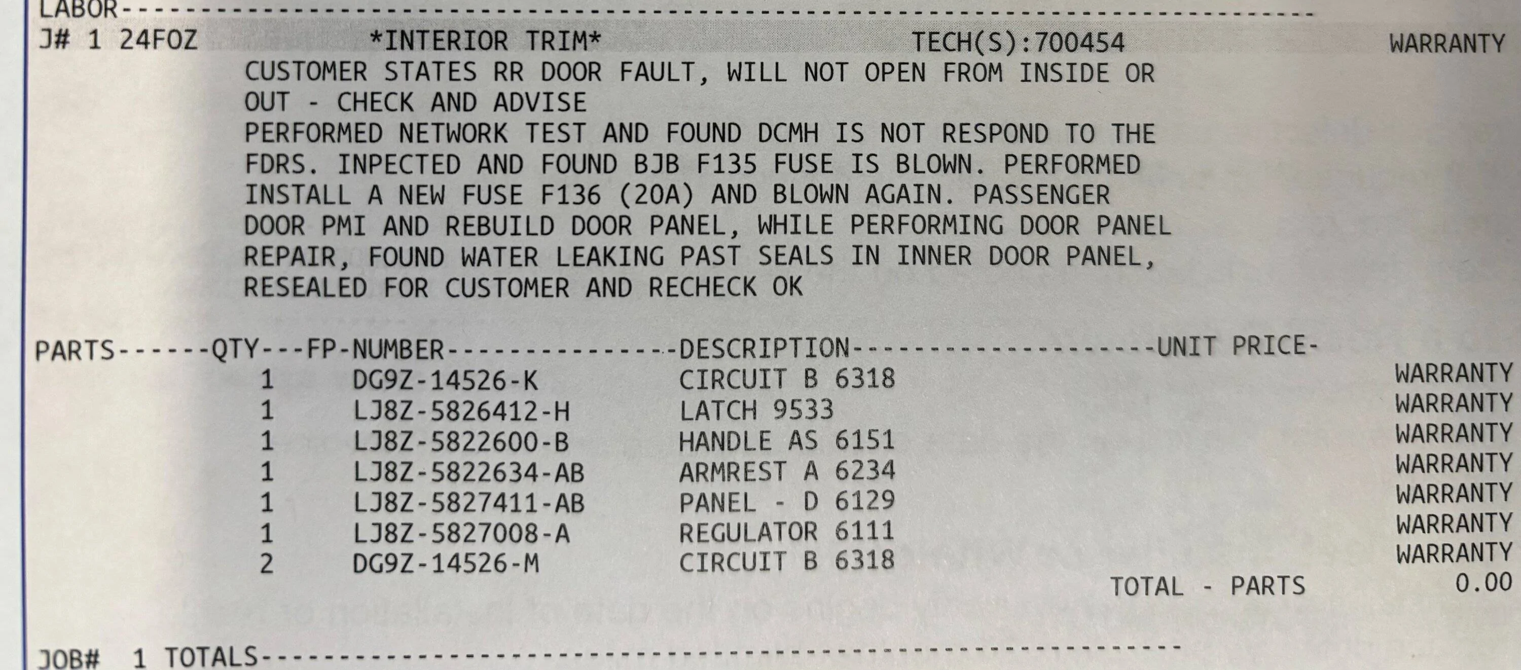

Final resolution - bad seals on the door permitted water to leak into the inner door panel. Water caused the door control module not to function. Two weeks in the shop (mostly waiting for parts as I understand it), but the issue is finally fixed.
Sheehy kept on top of this and kept me in the loop on the repair, so I would recommend them to anyone in Northern Virginia.
