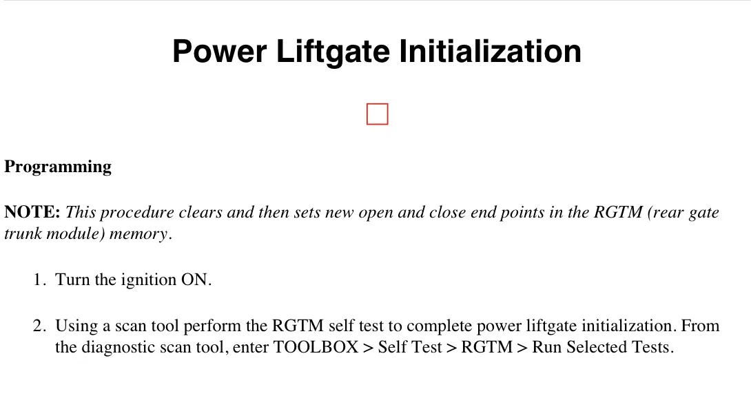

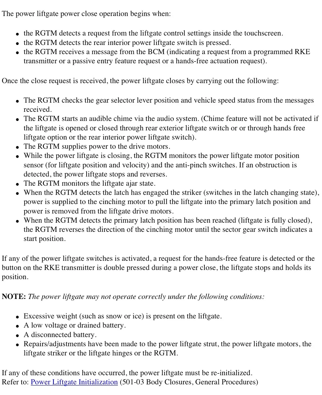

Not sure this can help you but from the repair manual, this is what is required for the liftgate to close. There is also a power liftgate initialization but that would have to be done by the dealer or someone with FDRS.

The post above got me thinking. I at one point double tapped the exterior rear button when trying to put my lift gate down. After this the issues started (now thinking back about it). So I went outside, pushed the exterior rear liftgate button to open the door, once opened pushed it once, heard the dings and nothing happened. I then tapped the exterior button (now above my head) twice quickly, heard the beeps again and the door closed. I then opened and closed it with all the buttons, infotainment, interior/exterior liftgate, and remote and they all worked. Strangely though I cannot replicate the issue by tapping the button again but I have a high confidence that is what caused it.
either way its working now and I am going to credit markboris because their solution is what triggered the thought process that got it working again. Cheers.
Edit: It could also be a complete coincidence that it started working at that time, I don't really know.
