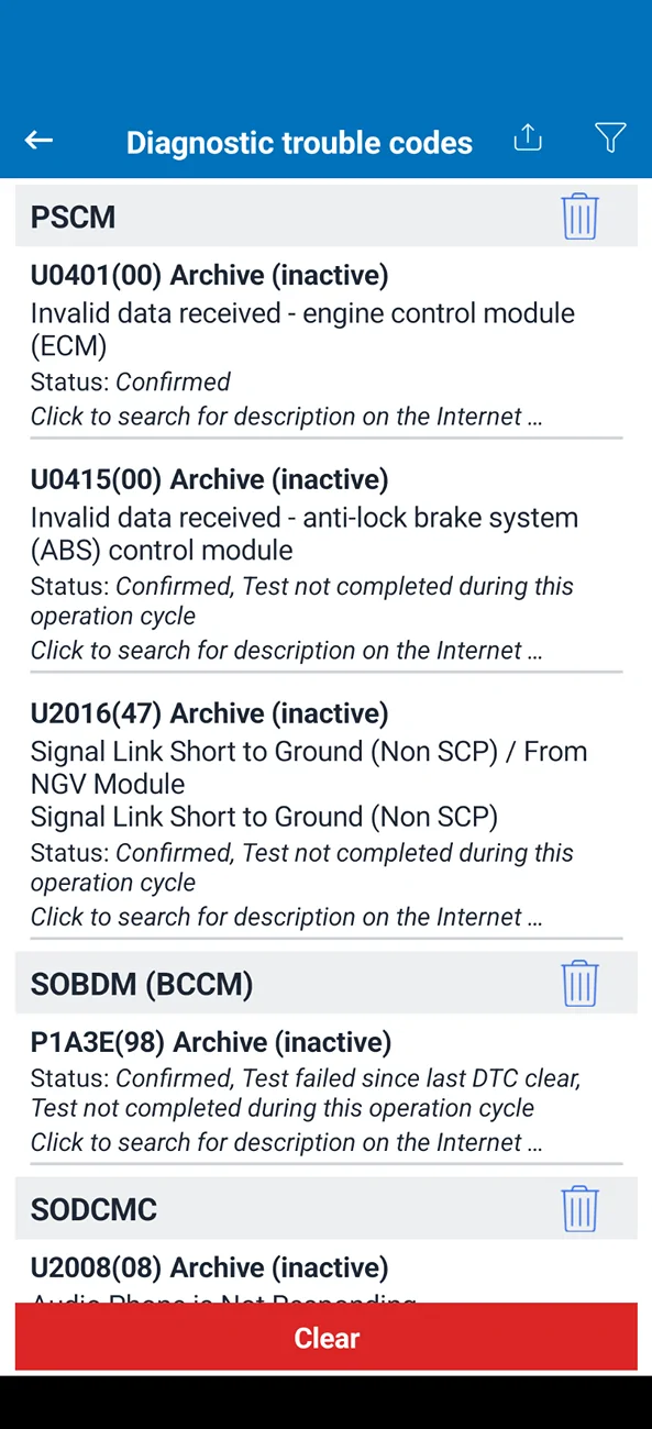

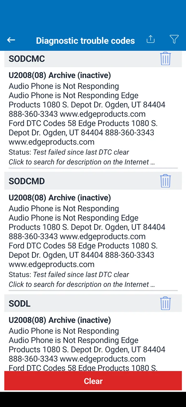

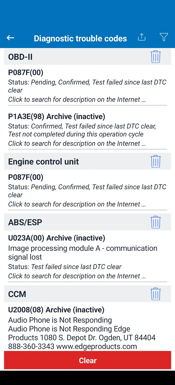

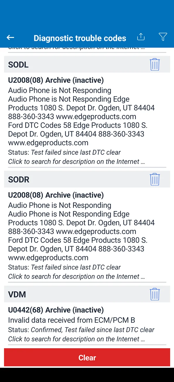

Hey folks, I've gotten 2-3 "1 pedal drive fault" messages in the past month or so. I suspect I'll be going to the dealer, but I wanted to gather other's experiences beforehand. I've seen TSB 24-2187 and CSP 24B42 mentioned related to this, but my concern is I don't see any DTCs from my OBD-II scanner.
I'm seeing P087F(00) and P1A3E(98) that stick out.
Should I expect a regular software update to fix the issue or do you all think there's something else going on? I'll attach the full list of error codes too for anyone curious.
