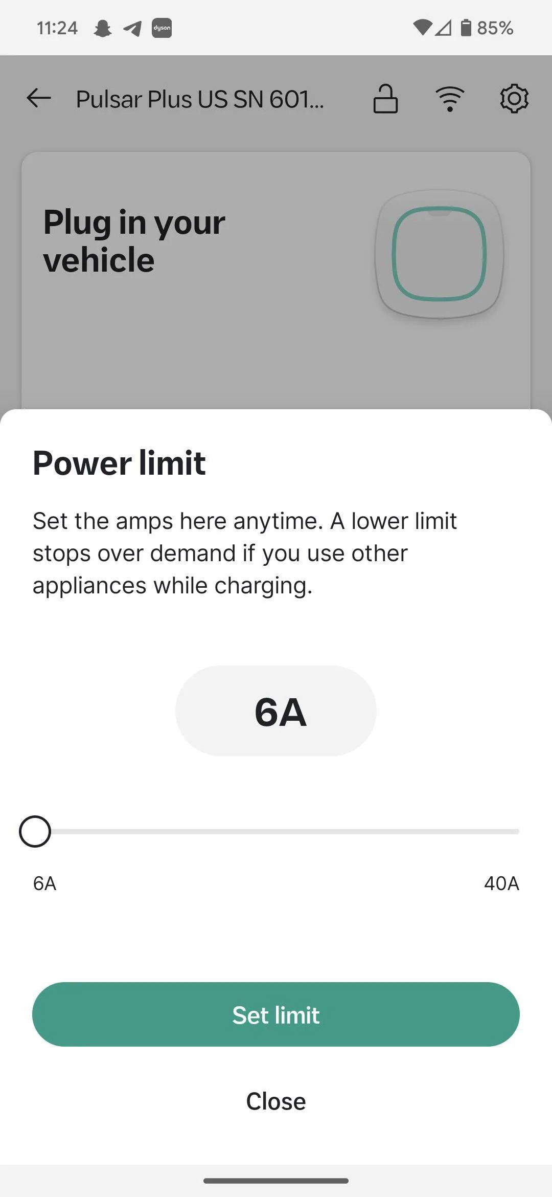

To elaborate on what general said, you can't do this on the car side, it has to be on the EVSE. Either change the rate on the chargepoint that you have or get an EVSE that allows for on the fly power delivery changes. I have the exact same situation you do. I leave the chargepoint at max amperage for night charging and I use a Wallbox Pulsar Plus on the solar side and regulate power delivery automatically using home assistant.
Ford Mustang Mach-E Regulate charging rate - can I control the % of power delivered to decrease watts so charging takes longer Screenshot_20230904-112425
