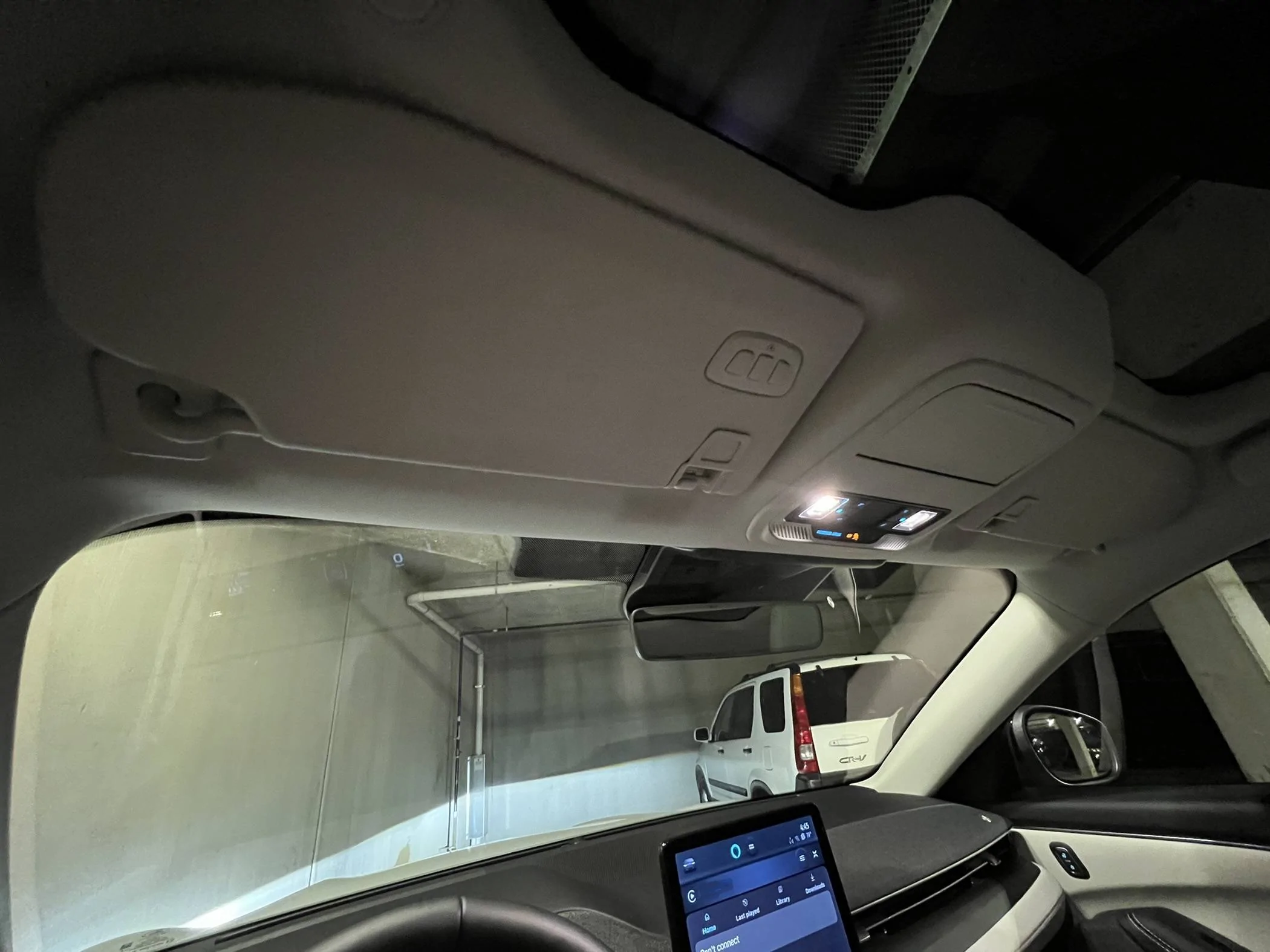

The standard air bag safety warning stickers on the two front sun visors were bothering me, so I went ahead and removed them. Voila!
I first tried what most tutorials suggested, which was to soak the stickers in isopropyl alcohol for several minutes. However, I found that didn't work to remove the stickers at all. It just made it possible to rub off the ink from the sticker, which wasn't my goal. I got the same lack of result with nail polish remover (acetone).

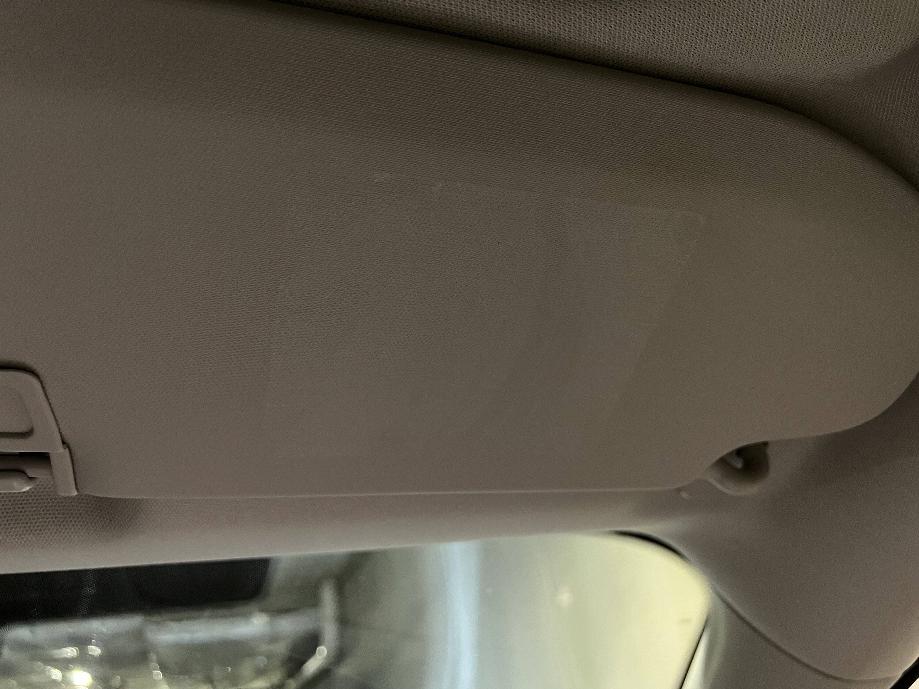

I then tried the hairdryer approach, and that did the trick. It took about half an hour of tedious and tiring work gradually heating up the sticker to soften up the adhesive and peeling back one millimeter of the sticker at a time, but it worked. I found an outlet to use, put the hairdryer on high heat, focused it on one edge of the sticker for about ten seconds, paused to peel back a bit of the sticker, and repeated. There's a little bit of visible residue left over that I couldn't remove with isopropyl alcohol, nail polish remover, or Windex, which I might try Goo Gone on later to fully remove. However, I'm still happy with the result as-is, so now my pretty Mach-E interior isn't marred by the bright warning stickers.
Just figured I'd post here in case someone else is looking for the best technique to remove these stickers from their Mach-E. Most of the other guides I've found are for a different sun visor material, and it seems to me like only the hairdryer approach works for the Mach-E.
