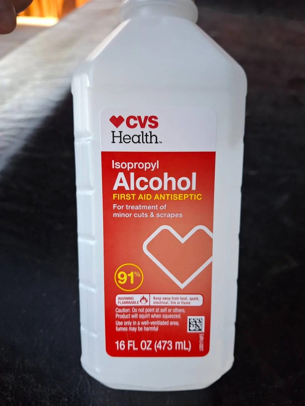

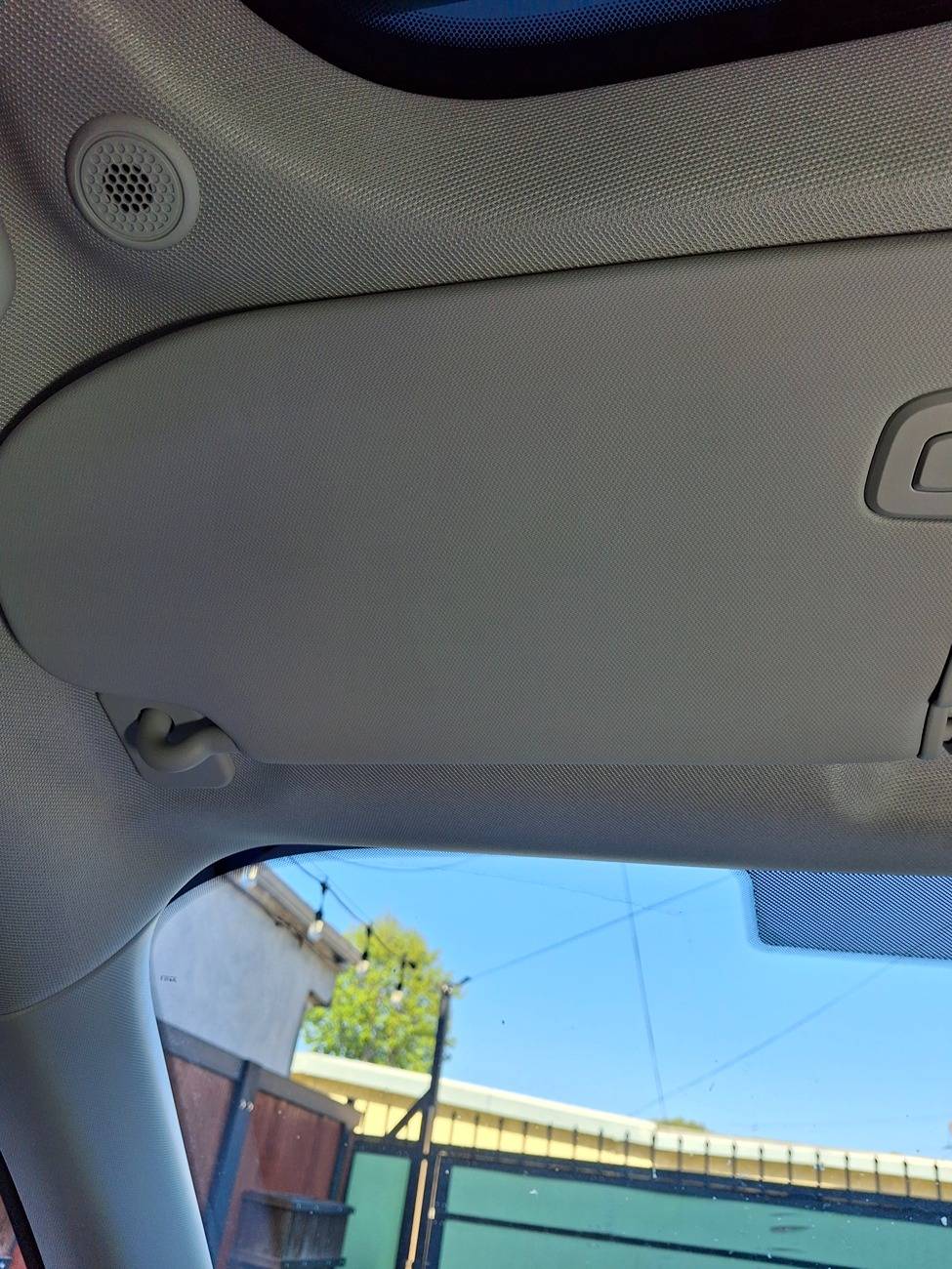

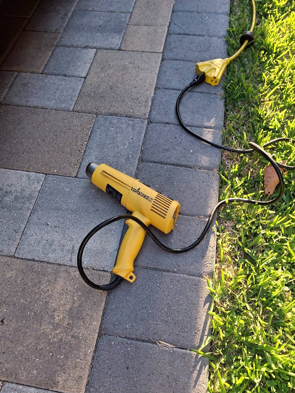

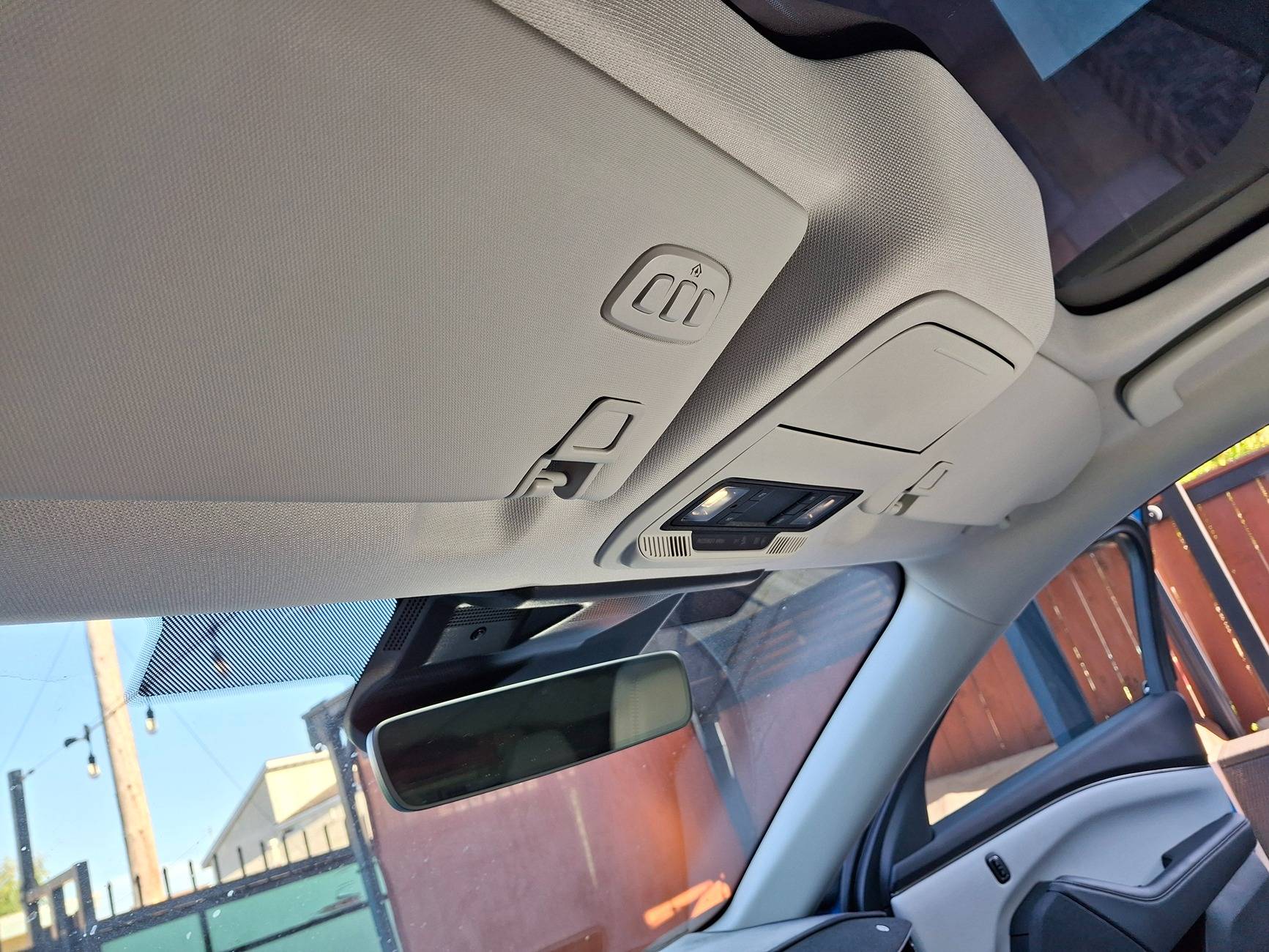

Just did mine. Didn't bother taking the visors out of the car so just did it with them on. Figured it would be more of a hassle than it was worth. Used a heat gun, rubbing alcohol, microfiber rag and plenty of elbow grease. It was recommended in another thread to use 99% isopropyl alcohol, but all I could find was 91%. Took about 10 minutes for each one. If you're handy w/a heat gun and have a good feel for how hot you can go, it's a huge time saver. I used it for both removing the stickers and then again for the glue. You can also use a hairdryer.
