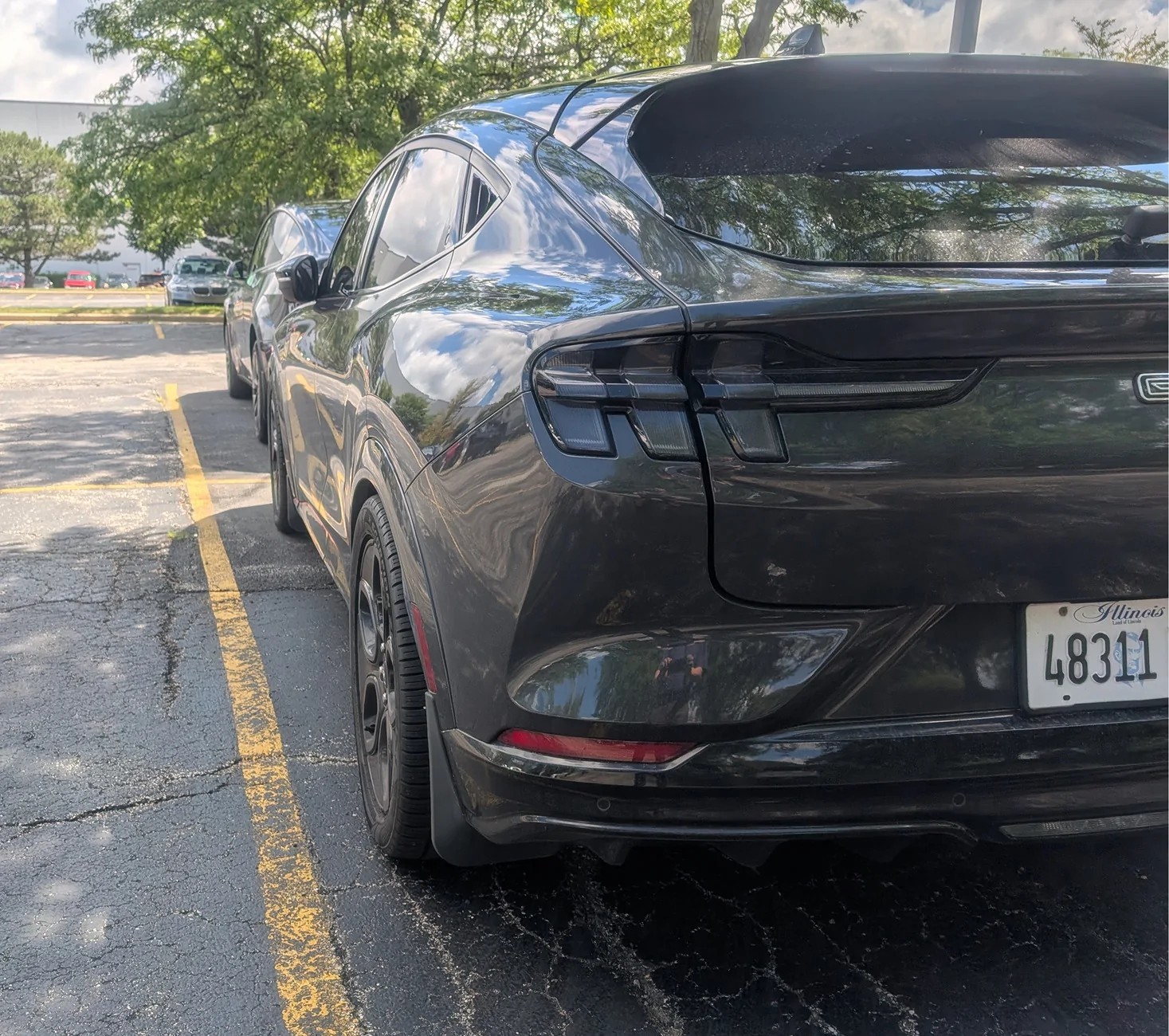

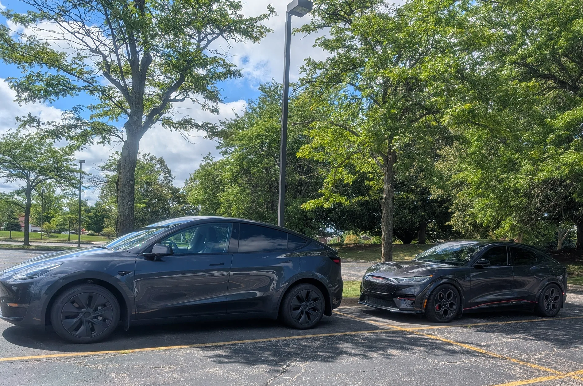

I lowered mine and have the Eibach sway bars. I used spacers as well. I went with 15mm as I thought that had the best appearance of being in line with the wheel wells (oh, and I put 255's on it as well). I did have to trim the bolts. I only hit the fenders if I hit something with speed, like a speed bump or a large pothole. Has happened maybe twice in about 16 months of this setup. Have had no stability or safety issues.
And yes, I intentionally took this picture to show how my gray looks so much better than the gray egg in front of me.

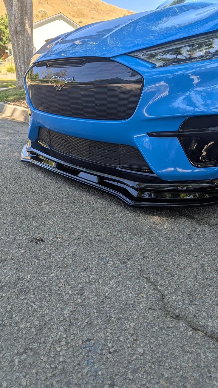

Thanks Mark, I love it when you share your knowledge, it's appreciated! I had a 16 gt350 and that thing barely got out of my driveway. Same thing with the mach but I will measure

I’ve always been a fan of your flower-style wheels—they look even better in person. The 15mm spacers really suit your car, and honestly, I think you could even pull off 20mm in the rear if you wanted to get more aggressive.

Dang, that’s practically kissing the ground! They actually make driveway ramps you can place at the bottom to help prevent your lip from scraping.
