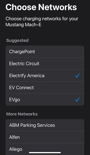

In iOS 17, there is one more screen before you are finished setting up your Mach-E for EV routing. You can pick your preferred charging networks.
Ford Mustang Mach-E Routing with Maps on iOS does not show charging stops IMG_6221 (1)

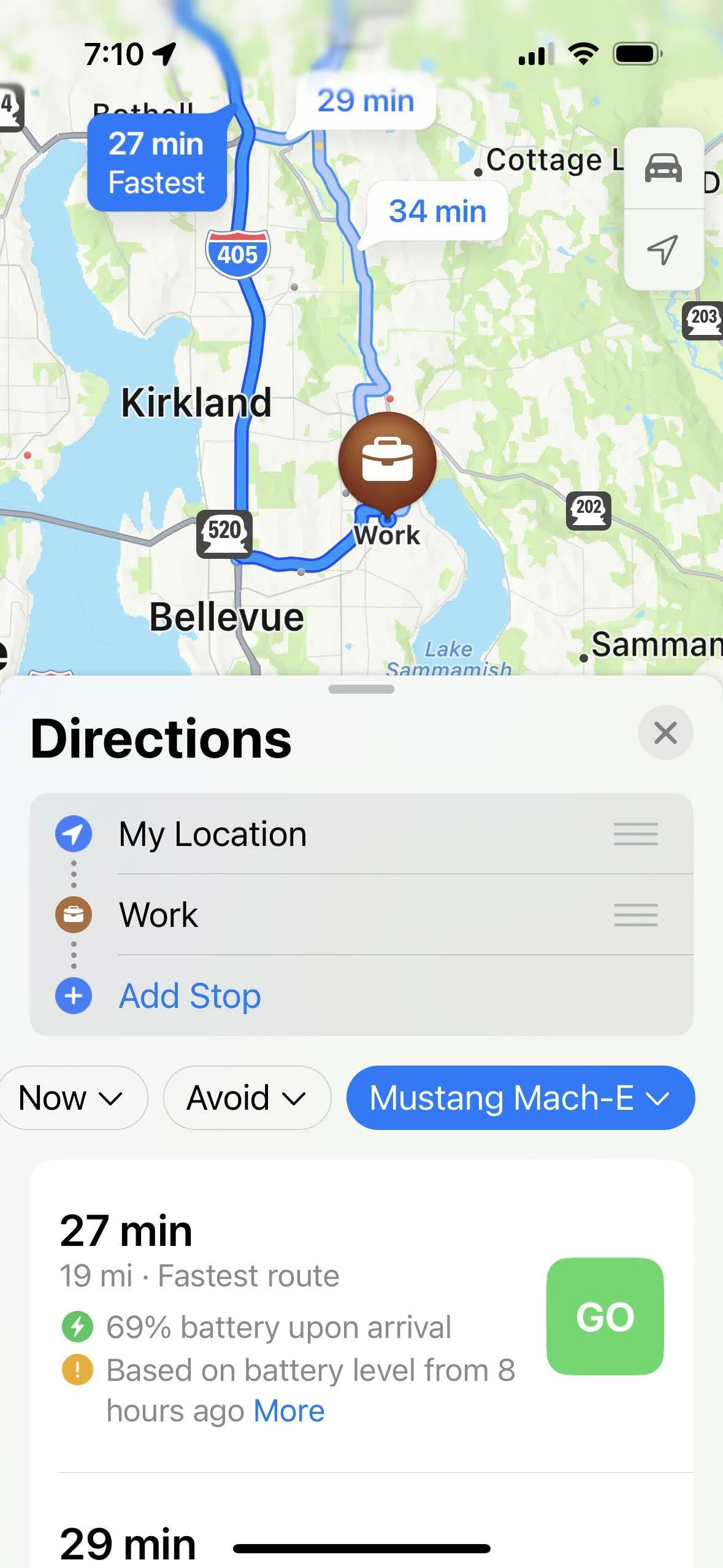

Once you add your car make sure it’s selected when routing. You want to select other car when you’re not driving the Mach E or don’t want to see the charging stops.
Ford Mustang Mach-E Routing with Maps on iOS does not show charging stops 1687183895691
