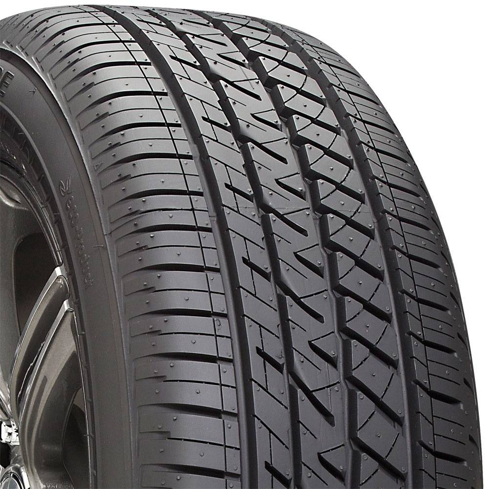

When it comes time for my MME, I am looking at one size up (235 / 55 / 19) since there are no OEM sized RFT:
Ford Mustang Mach-E Run Flat Tires BRANDPLPlogo_bridgestone_tir
BRIDGESTONE DRIVEGUARD 235 /55 R19 105H XL BSW RF
Ford Mustang Mach-E Run Flat Tires brihfq.ang.xl

I would not go run flat, they have a very stiff sidewall because you need to be able to drive on it with no pressure. It will be a harsh ride on the MME. Also, the driveguard is not low rolling resistance and will cost you range. as much as 10%
Also with the higher load rating you need to run those at 36psi or you will wear out the shoulders first. That too will be less efficient.
If you didn't know even BMW has given up on run flats.
