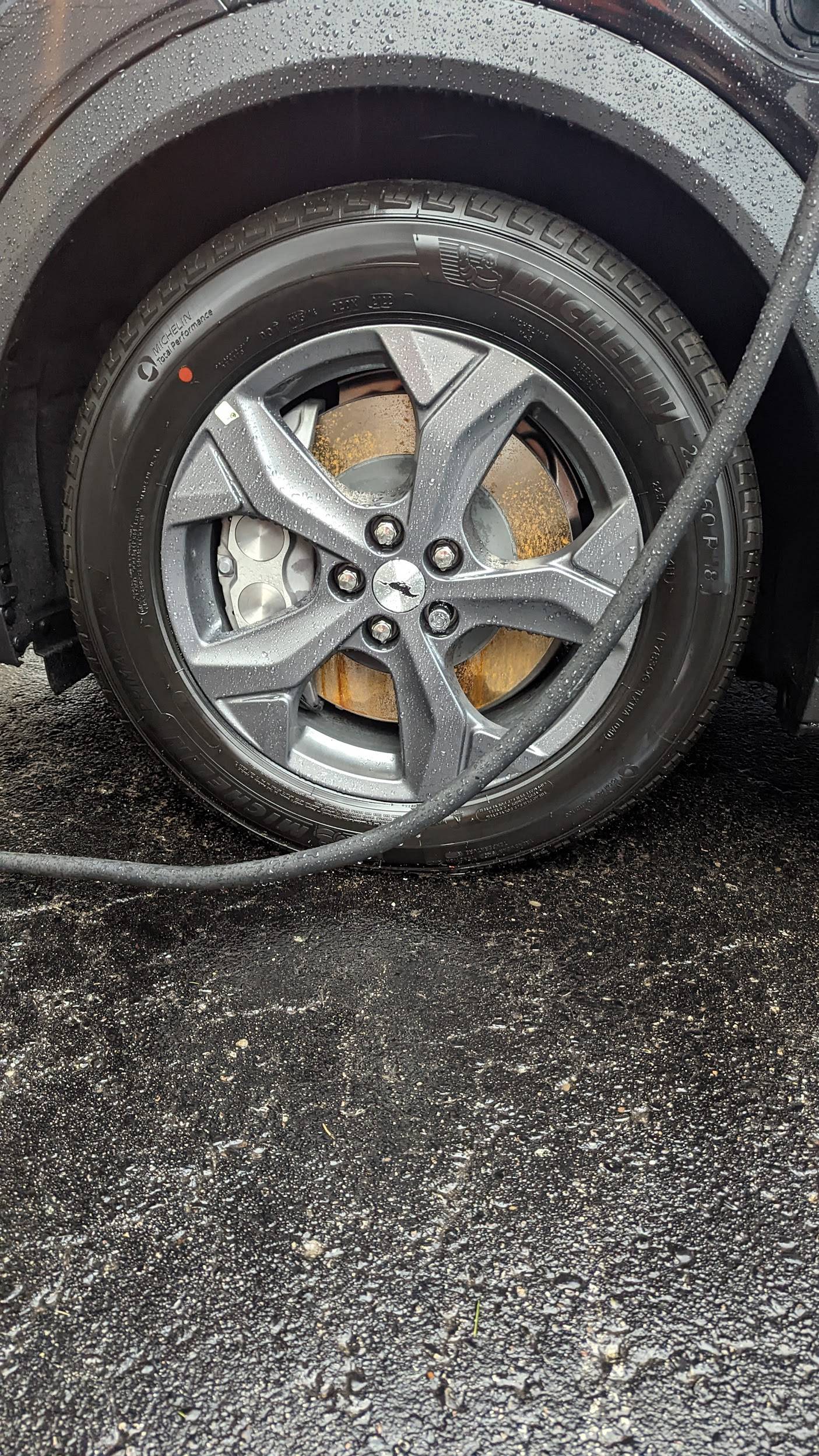

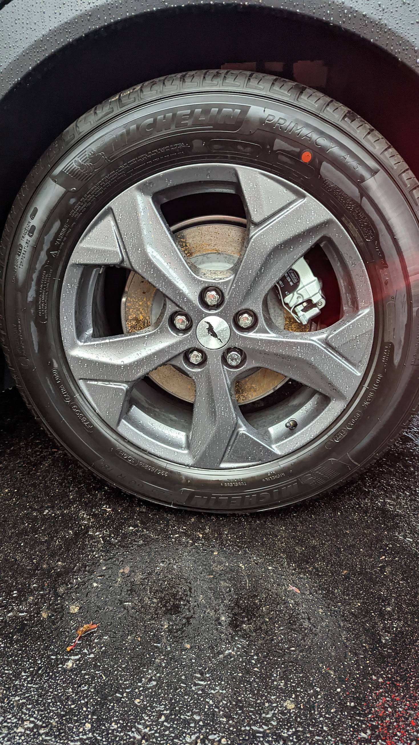

I picked up my pony yesterday, and this morning I found brake discs were severely rusted. Rusts were gone after I drove my kids to school. Has anybody had same situation? Is it normal? Is there any way to keep them from rusting? Thank you.

It's a bit extreme to call that extremely rusted. You haven't seen rusty rotors! ?
Just use your brakes more, and it'll clean off the surface. You will see this after it rains or you wash your car and let the water sit.
If it truly bothers you, you can buy aftermarket rotors that are coated/have treatment.

That’s surface rust from rain, and is perfectly normal with all cars. The next time you drive, slip it into neutral before braking to clean it off.
Yup, mine rust whenever I wash (it doesn’t rain here). Apply the brakes and the surface rust goes away. The only cars I ever owned that didn’t rust the rotors had hubcaps which were not conducive to cooling the brakes. ??

It only takes a car wash at your drive way and an overnight sitting to get a little rust like that. It doesn't affect braking in anyway. I don't think you even need to apply your brake to clean it, since the brake pads touch the rotors at all times if EVs in that regard are not different than ICEs.

It doesn't even take an overnight sitting. Mine look like that within 10 minutes of getting wet.
In what car do the brake pads contact the rotors at all times? That would get very hot very fast.

Surface rust is normal when rotors come into contact with water while parked on any car. Probably biggest difference is that EVs use the actual brakes less so it might take just slightly longer to clear the rust but it should be gone from virtually any drive.
Reading the title I almost knew immediately that the picture would show rain, years ago before I knew this was a normal thing I had the same question.
