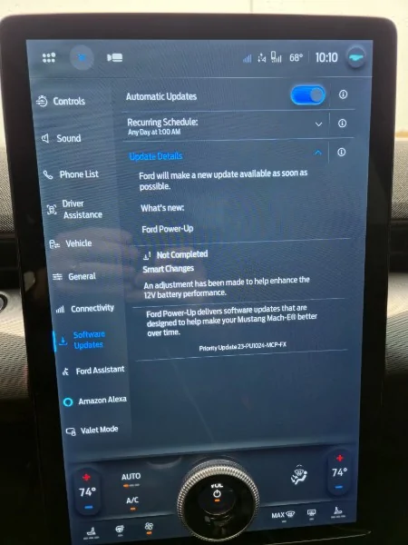

This is what I'm seeing.
This is a different update than the recall updates. It's older and the recall updates supersede those older images. 🤔🐩
