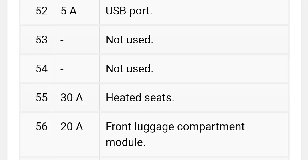

I think @Maquis is correct. 55 is a 30A fuse and it's showing heated seats is the only thing on it. The AC compressor is on a different fuse.
Ford Mustang Mach-E Seat Heaters Permanently On Screenshot_20230816-074244

Yes, fuse F39 in position 55 (30A) will disable the heated seats. However it's a pain to get to since you have to remove the frunk, so I'd recommend just unplugging the connector under the seat. You'll probably lose power seat functions while unplugged, so just move it where you need to before unplugging.
