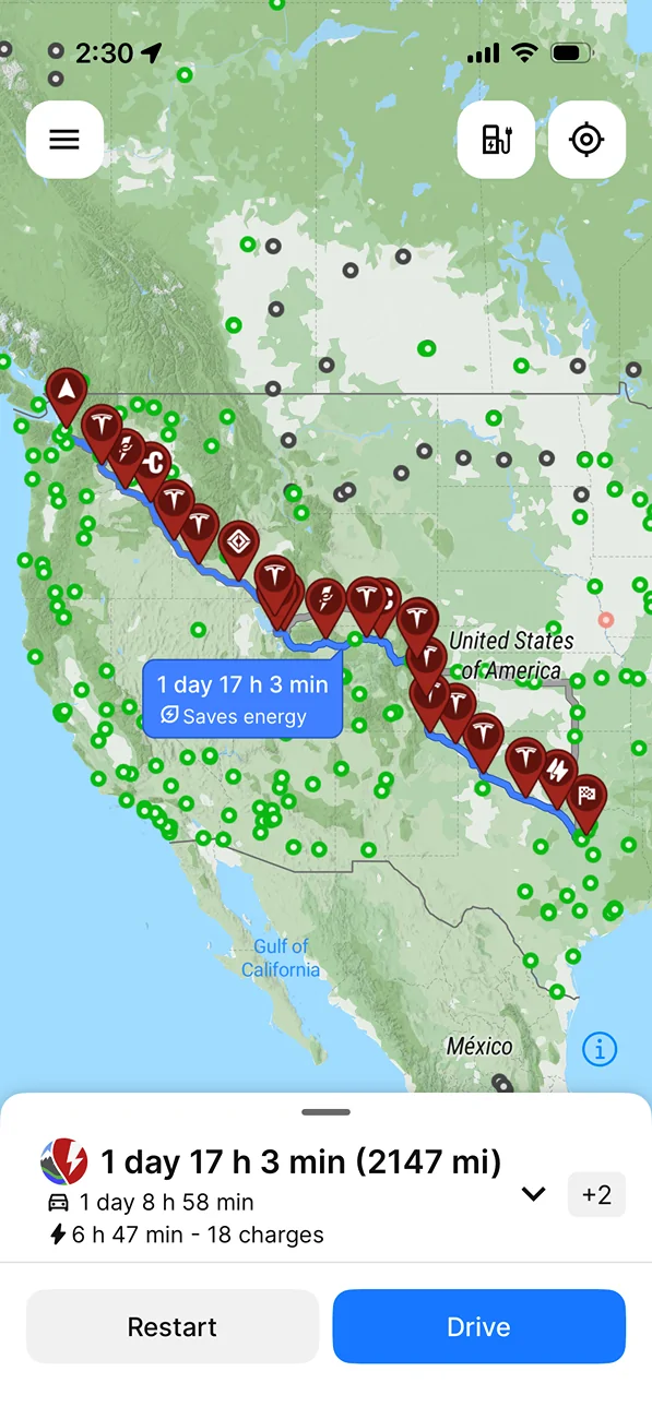

I’m thinking of taking a short drive from Seattle WA to Dallas TX via Butte MT, Salt Lake City, Denver.
But I’m having second thoughts.
Change my mind.
I did a potion of that route (Sequim, WA to Moab, UT) round trip in Nov 2023 in my Cal Rt 1 trim MME with no problem, and that was pre Tesla charger access and using the built-in navigation exclusively. I did the more direct route for that trip, but your plan of Butte to SLC should work just fine too according to ABRP (used my current Lightning profile in ABRP).
I drove the 80 mph speed limit when available, hit cold, rain, and snow in both directions. There's more charging options now and more navigation and planning options, your trip plan should be plenty easy.

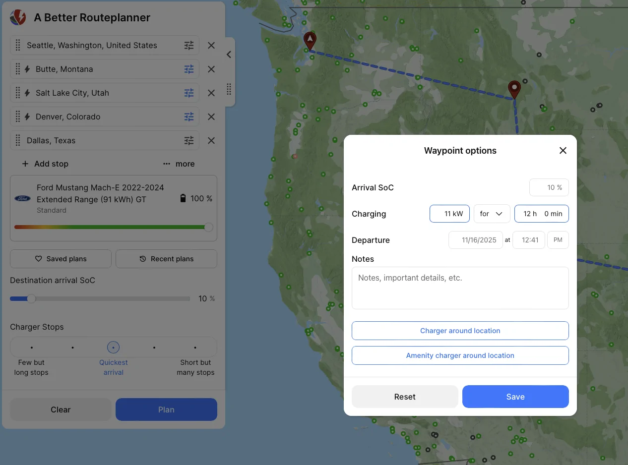

None of these apps are capable of automatically planning overnight stops. Start each day at 100% and you can save significant time on stops. If your destinations of Butte, SLC, and Denver, are overnight stops, configure each one to include a L2 overnight charge when you input them on the ā€œwhere do you want to goā€ screen. If I were to do this road trip, I’d probably add another overnight stop somewhere near Amarillo or deeper in TX—I’m not a fan of 14 hour days.
Ford Mustang Mach-E Seattle to Dallas Screenshot 2025-11-16 at 12.41.32 PM
That will improve the automated planning from 22 to 16 charge stops, and several of the remaining stops in ABRP are nonsense stops for ~5-10 minutes of charging and 5 minutes of overhead. Slow down by a few mph for that section and you save much more time by skipping the stop than you lose by going a bit slower.

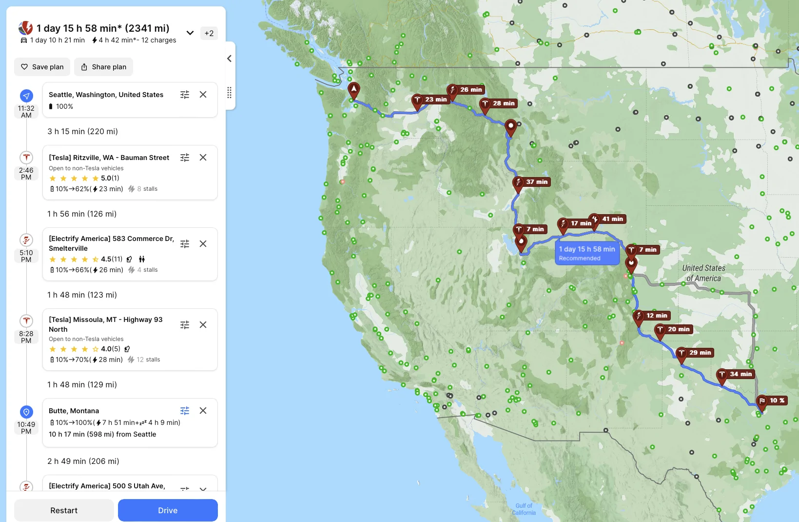

And with a bit slower speed than the default in ABRP, I can easily get the total number of stops down to 10-12, or half as many as ABRP plans. And given my experiences with road tripping in these states, that makes a lot more sense than ABRP’s default results.
Ford Mustang Mach-E Seattle to Dallas Screenshot 2025-11-16 at 12.36.27 PM
