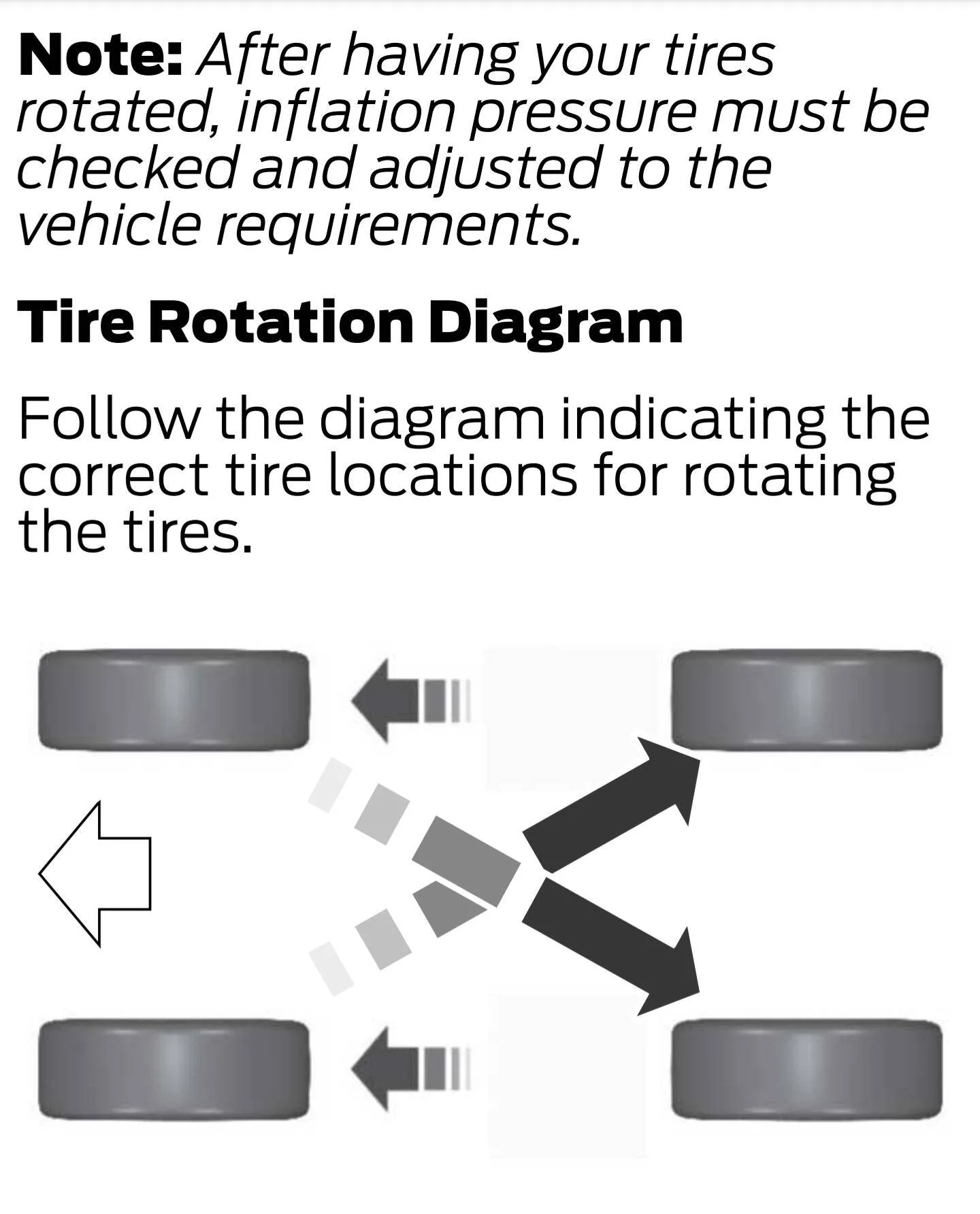

Rotating mine right now. Manual says back to front, then switch front to back.
TPMS will auto detect which tire is where after an hour or so of driving

Thanks Steve. Just to clarify, either rotation pattern is okay? Front-back-swap-on-same-side or the diagonal-fronts-to-opposite-rear pattern? I am familiar with the margin factor on torque wrenches, and yes, a torque wrench whose nominal top end is 150 is not a good idea here. Thanks for the details on TPMS reset.
Either rotation pattern is OK. I have been using the back to front, cross fronts to back in my rotations. ??

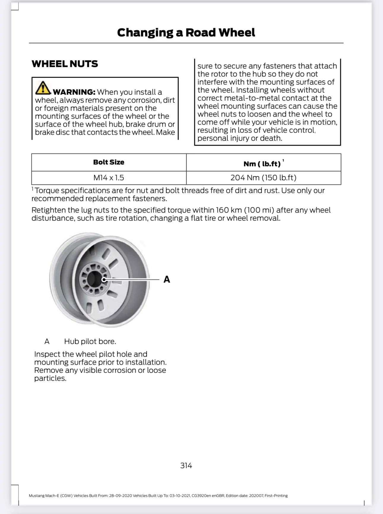

AND to avoid lost wheel syndrome, follow the golden rules:
• Re-torque wheels after 100 miles
• Before refitting a wheel, ensure mating surfaces are clean & free from paint, dirt, oxidation etc and don’t apply lubricant to any surfaces inc threads, only centre of the wheel (spigot) should ever be lubricated.
This is good advice, especially on re-torque. The stock tires on all MME models so far (through the 2023 model year) are not unidirectional so the X pattern is fine for rotation unless aftermarket tires are involved. In that case, one needs to know what they bought. ??

Except for a brand new set of steel trailer tires I’ve never found lugs that were undertorqued after 50-100 miles (after proper initial torque) so I’ve been negligent on the retorques lately. It’s a good reminder, but hasn‘t shown necessary in my experience. And consider that the majority of people don’t have a 150 ft-lb torque wrench (and may not know how to use one) and aren’t taking their vehicles back to the shop after 50 miles.
