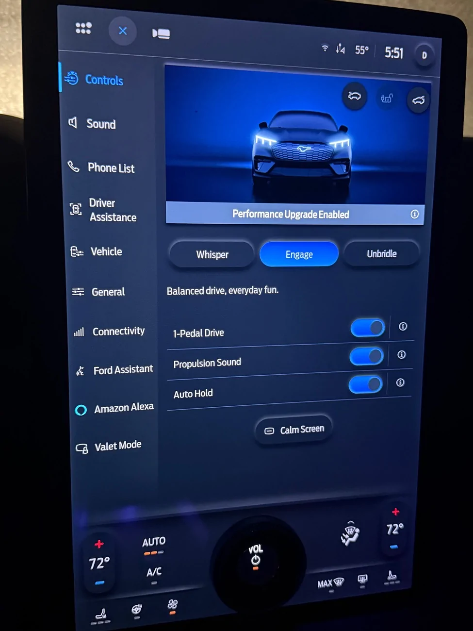

Post a picture of what you see when you press the car icon on the top of the center screen

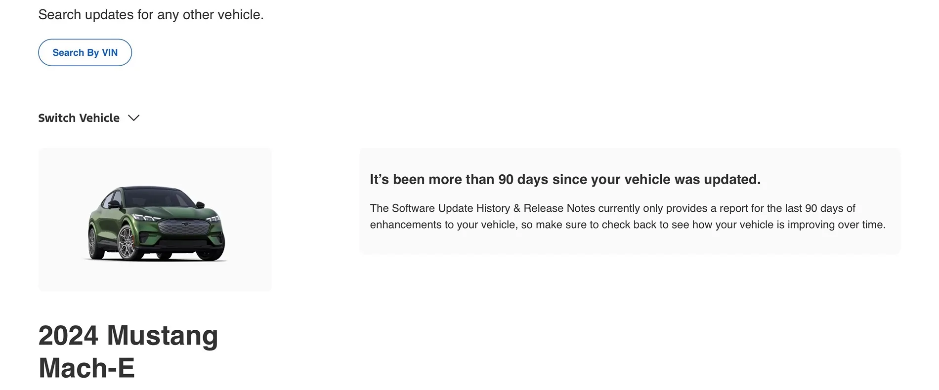

https://www.ford.com/support/software-updates
if you login it should have a list of your registered vehicle(s) and show something like
Ford Mustang Mach-E Software update page missing in SYNC IMG_0589
I should add that this page looked different yesterday, before I brought it to the dealership, the vehicle image was on the right, there were 2 bullet warnings on the left. 1 for sync and 1 for navigation.

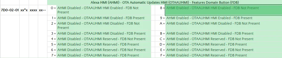

@green_machine Message me the VIN. I've seen the config for this get turned off a time or two. I don't know how it happens, but it somehow does.
If you know your way around FORScan, check what you have here in the APIM:
Ford Mustang Mach-E Software update page missing in SYNC 1765470442358-wd

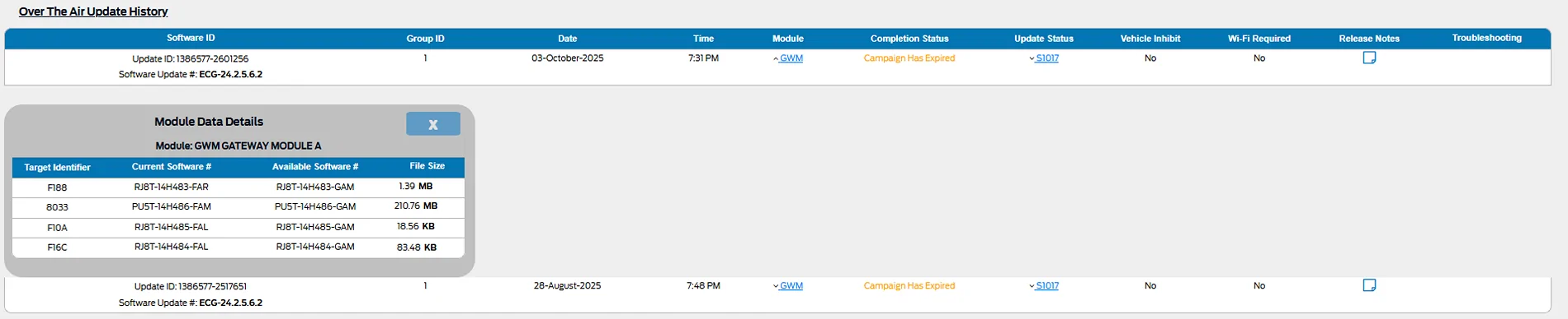

This is what I see on the cloud:
Ford Mustang Mach-E Software update page missing in SYNC 1765473576085-jk
Checked two other 2024 Mach E and they also show a 0 there (which means OTAs are enabled), so that's not it.
I'll dig through the spreadsheet to see if I see anything else related to updates in the APIM. However, there is so much sh*t in the APIM that uses acronymns that could mean anything. Very strange.

Well, there is the issue. Why tf would they let the vehicle go with corrupted firmware/config in the GWM? Your connectivity seems to be working, but it is reporting limited data to the cloud. I see the tech notes said the code went away, but I call bull sh*t. The GWM OTA that was sent to you didn't fail per se......you vehicle never pinged the server back to accept it so it timed out.
They did update the GWM. If you look at the details of the failed OTA, the GWM was previously on the FAR strategy and FORScan now shows it is on GAM, so they did do the update that was not able to go through OTA. PTS also shows auto updates is turned on in your car.
Ford Mustang Mach-E Software update page missing in SYNC 1765477233509-hg
Hard to tell based on this if the GWM is toast or if there if there is bad data on the server side that is corrupting the GWM, but a misconfifgured GWM can cause all kinds of weird issues. You can try disconnecting the negative cable from the 12v battery to force a hard reset. Very unlikley that will fix anything IMO, but it won't hurt anything to try.
