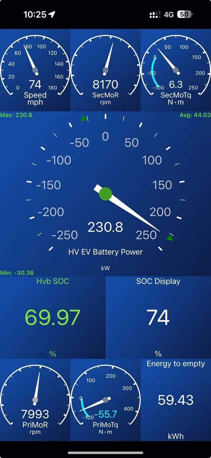

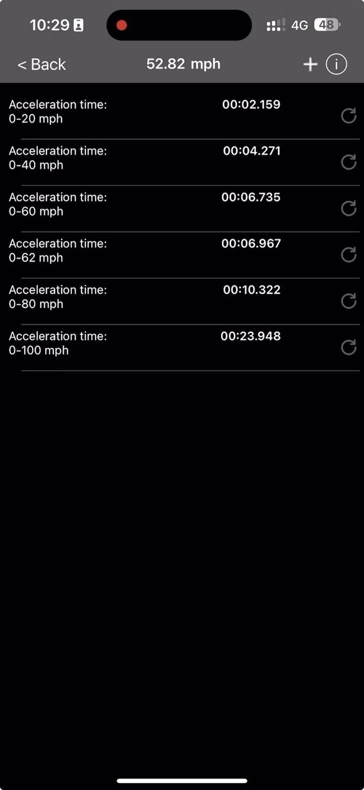

Just before it was paused dealer performed the recall and applied the PCM updates, when I got car back it loss around 1.5-2sec 0-60 acceleration 2021 AWD ER, also on the max power it seems to be topping out at 230kw nowhere close to the spec of 258kw. Ran these tests, using car scanner at 92% SOC and later 62%. Dealer said they have identified a bug and working to fix. Not sure if anyone else noticed this?

FYI maximum power is dependent on battery temperature and SoC. The battery must be fully warmed up to get maximum power. That means 25ºC or higher. Precondition to a DC charger, then run your test again with 90%+ SoC and 25ºC minimum battery temps.

Will give it a go again, interested to see the difference, but its not been the same since the update never had to find a goldilocks zone before

Makes sense to slow it down and limit power not to burn out the HVJB. Would not be the first time they slow down a system so it does not melt.
