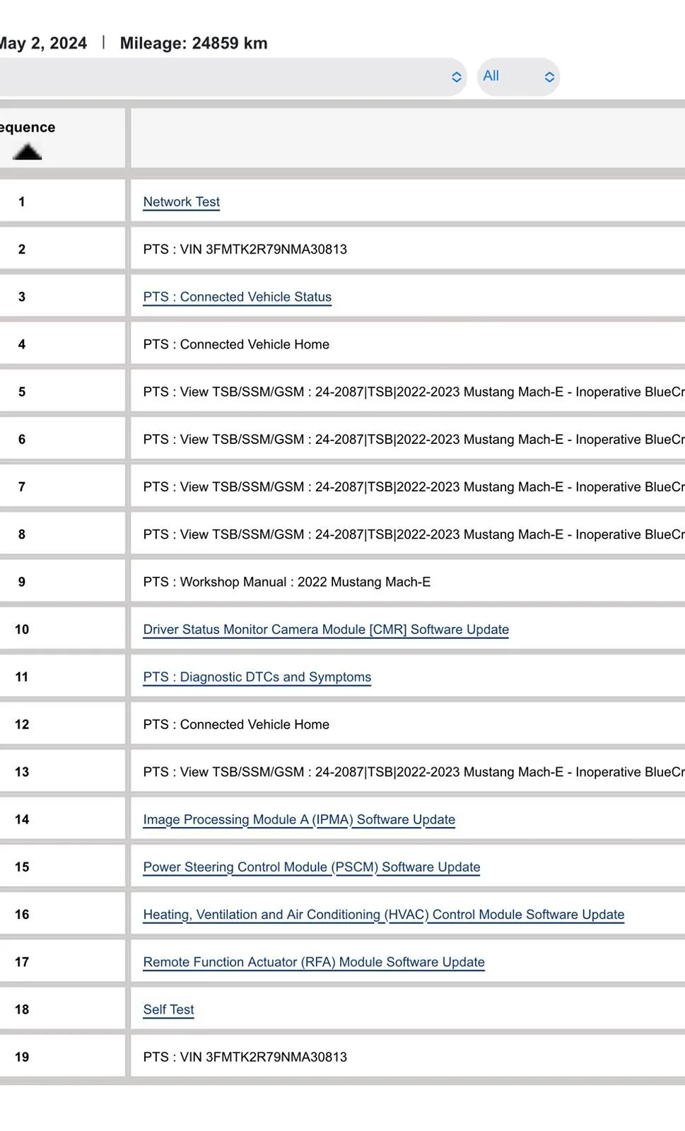

So looks like they are just performing every module update on your vehicle. It would partially explain why you don’t have a reliable status available. They have been at it for the last 4 hours. Currently still going.
Congrats, at least you’ll have bluecruise 1.4 when you get it back! :cool:
