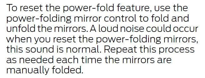

They were manually folded in transit and need to be reset, its in the manual.

Oh ok..thank you. Will start reading the manual next.
Probably a good idea. Might help. There is also a section under settings on the main screen where you can turn the folding mirror action on/off. That is also in the manual. Might be an idea to check that as well.
Just closing out on this. This step worked perfectly fine, and now the mirrors behave !
Thank you for the quick help.
