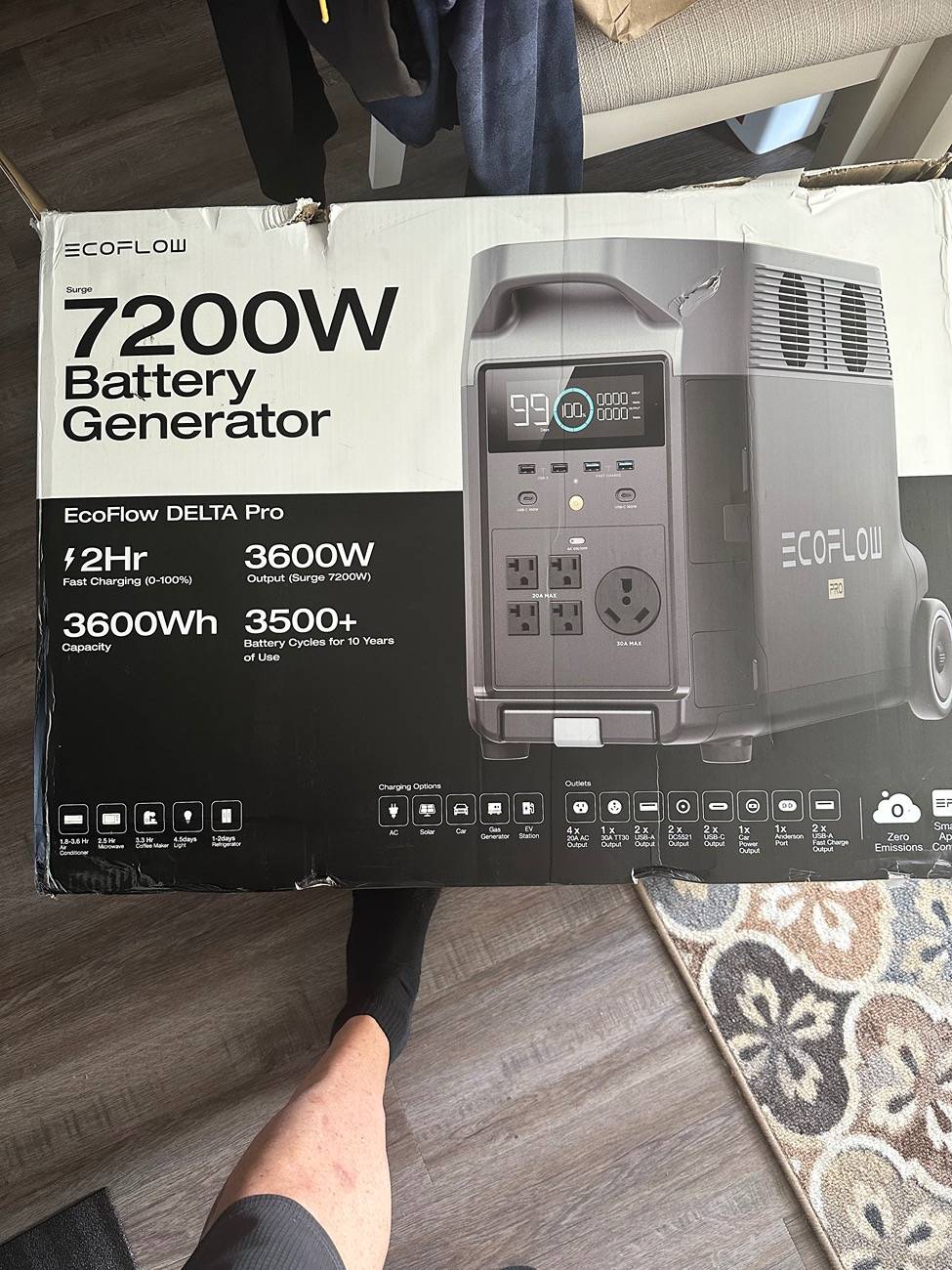

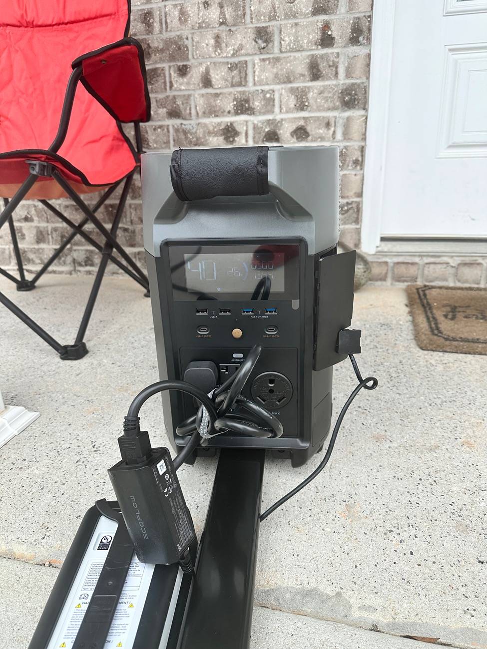

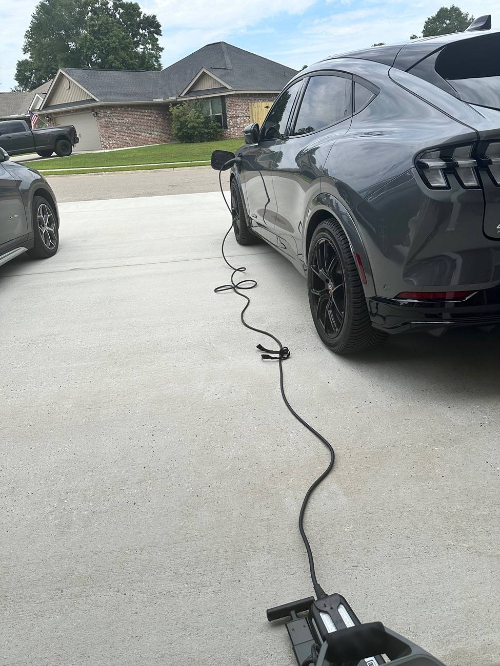

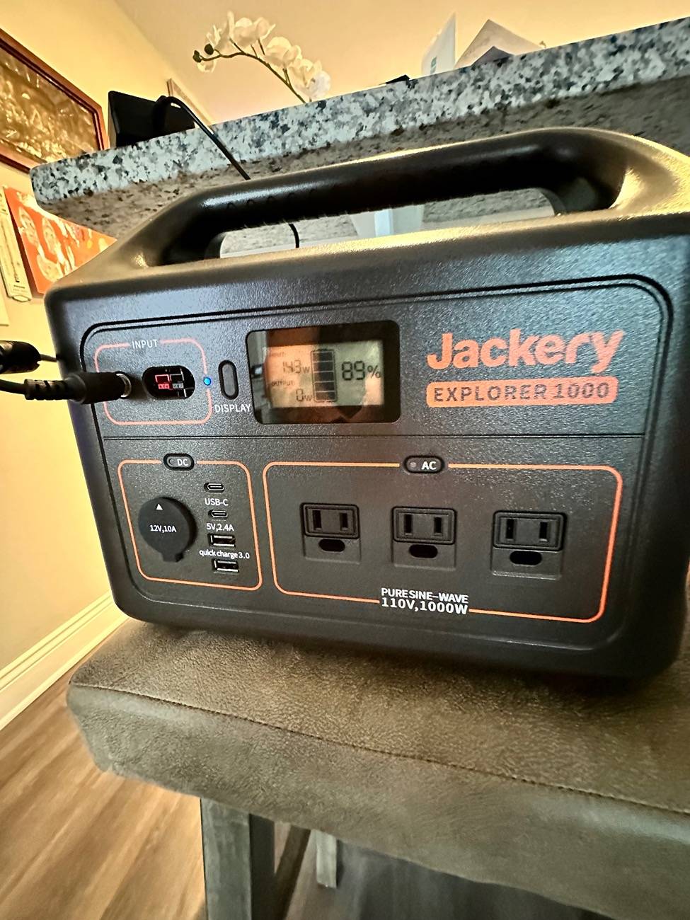

I have both solar generators you mentioned, 2 eco for 7200 kw small jackery 600 for small things, only had the one Eco when I got the car and I did get the attachment they had I think I was able to add about maybe 10 or 12 miles with a full charge on that one generator 3600 KW can’t remember, but it did charge it, and I got the solar panels for it I may try hooking up both and see how much it’ll charge the car run them both dead and then see how long it takes for the solar panels to charge them back up.

Time for electricity math, the battery in the picture is a 3600Wh, divide that by 1000 to get to kWh which is the standard measure for our batteries and utility power. 3,6 kWh is not much in a 91 kWh battery.
