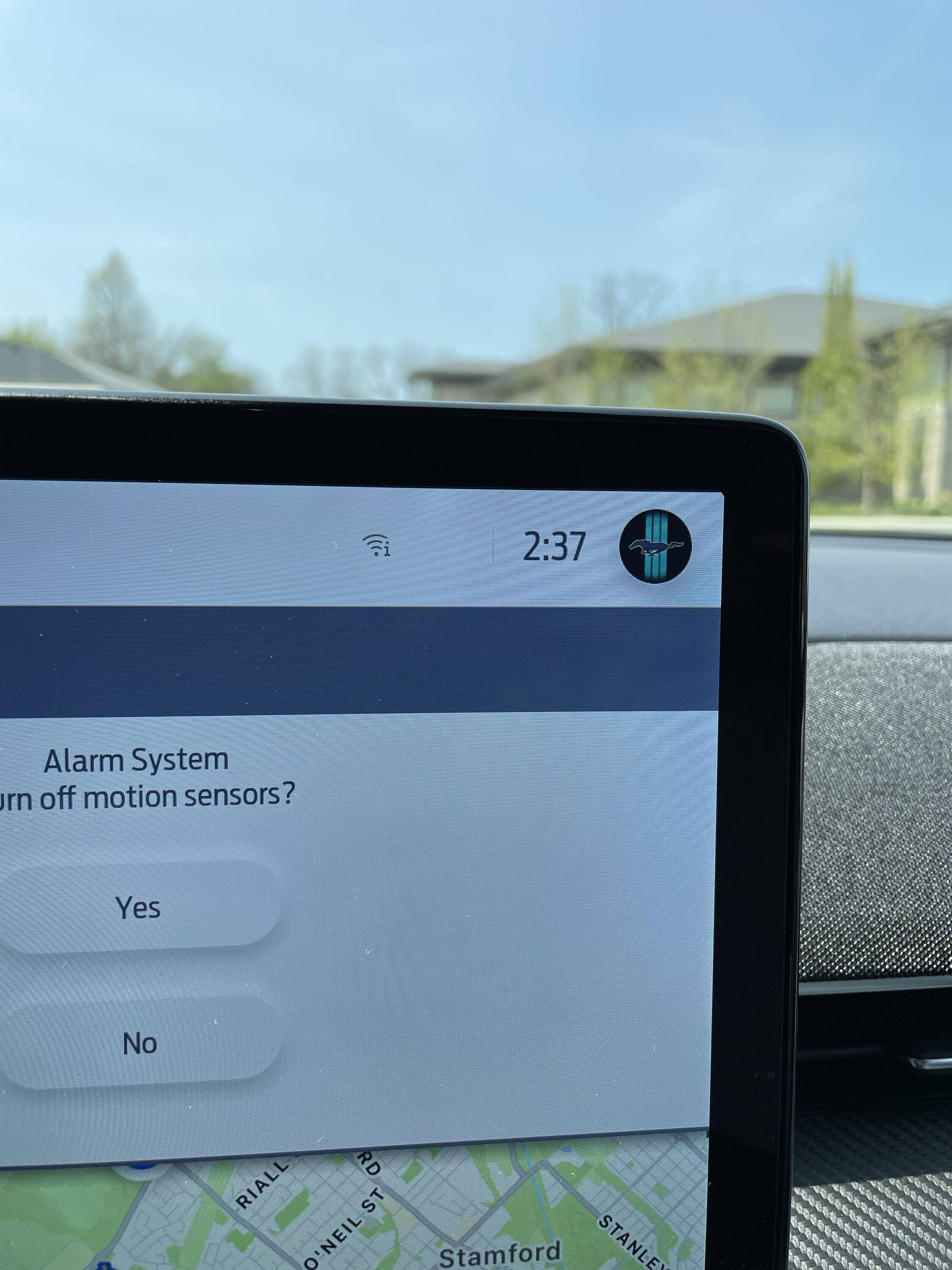

In the last month, I have had items disappear from the status bar. I was on 3.6.2 the first time I noticed that the Vehicle data sharing icon was missing. And that time the vehicle data sharing icon was missing for many hours, but finally came back.
Sometimes I have nothing but the time showing. Is this another software bug in the Sync software? I am now up to 4.2.5.

It’s a known bug and they’re working on it. I think it’s due to server issues, so nothing you can do on your end.
As you can see in the screen capture, I don’t even have temperature showing. That’s what leads me to believe it’s more of Sync software acting up.
