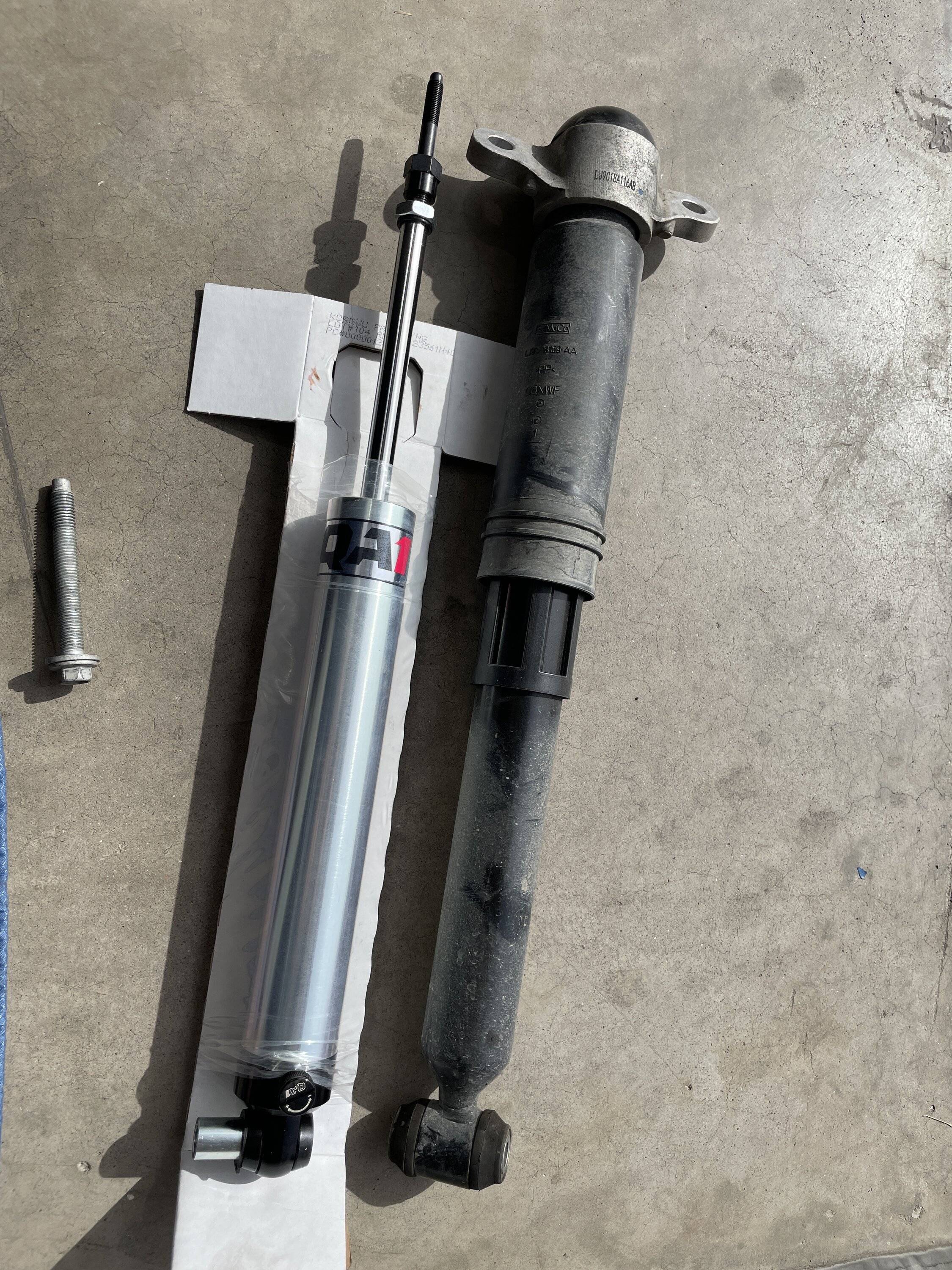

Welp, I pulled one of my rears off and took a couple measurements. Realized I'm going to lose the car on Wednesday to the dealer for a while so i took some measurements and tossed it all back together. About 3 minutes ago realized I didn't get the ID of the lower eyelet. Which was the ENTIRE point of pulling it off anyway. I got 4 of the 5 I wanted/needed. This is why you don't work on cars when you're sick :(
What isn't obvious in the pic but is if you put the shock on backwards is the lower eyelet on the stock shock is cocked about 8 degrees. It might be the rubber that they put in there to make up for tolerances but I put the bottom in opposite the way it came out and the top mount was off by an inch or so.
Edit, I remember why I didn't measure the ID. The QA1 is 14mm, next step down is 1/2 or 12mm. one of those will work. But if someone was to confirm tha'td be great. The bigger 'problem' is the sleeve bushing is 2.46mm wide. 2.5 might fit but that size is really uncommon.

Erik, I did measure the ID of the rear lower shock tube and got 11.7mm so very close to 12mm like you said it might be.
