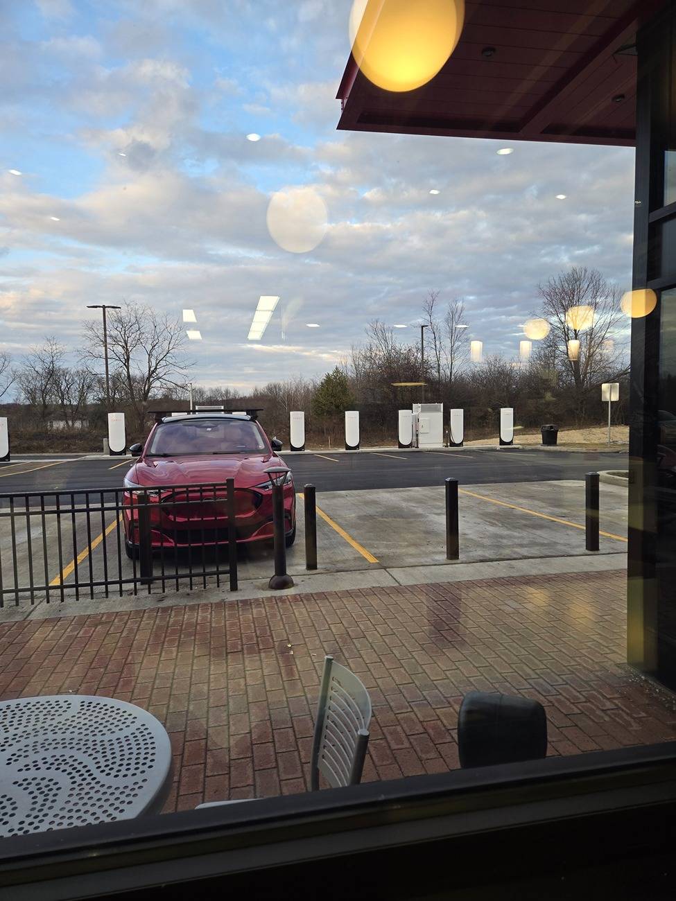

A new Sheetz location opened in the past week with 12 Tesla V4 stations. Yes the cords are long enough but these V4 locations will not activate on your Mach E. See photos. Guess they will work in the ....soon.

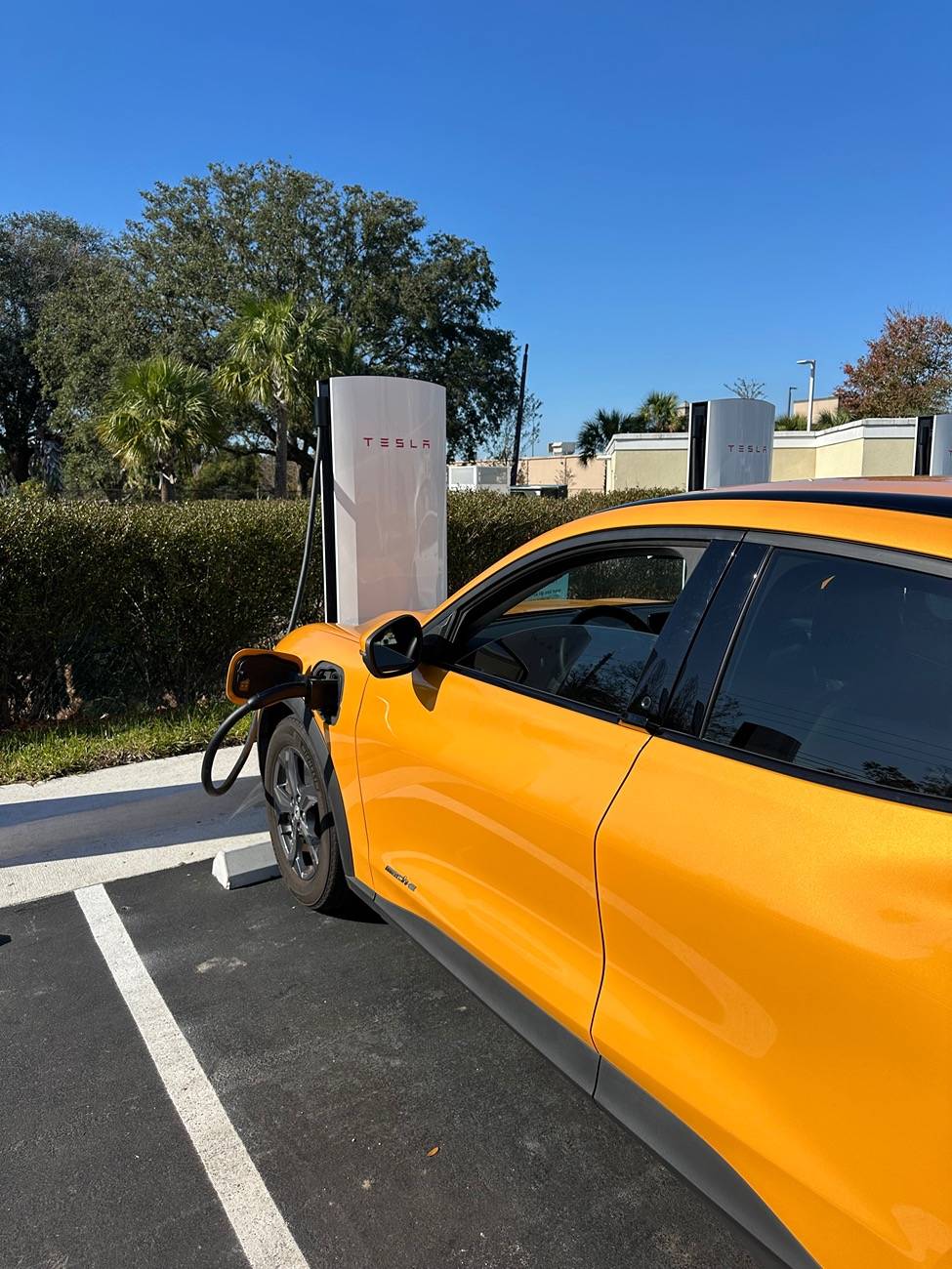

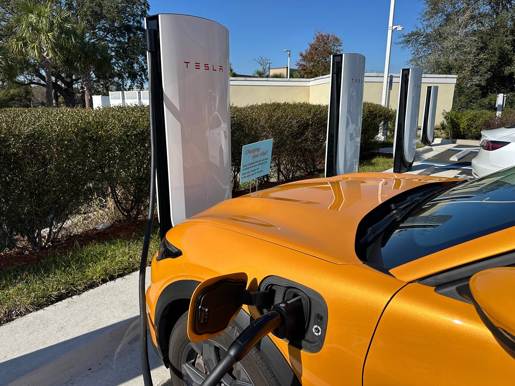

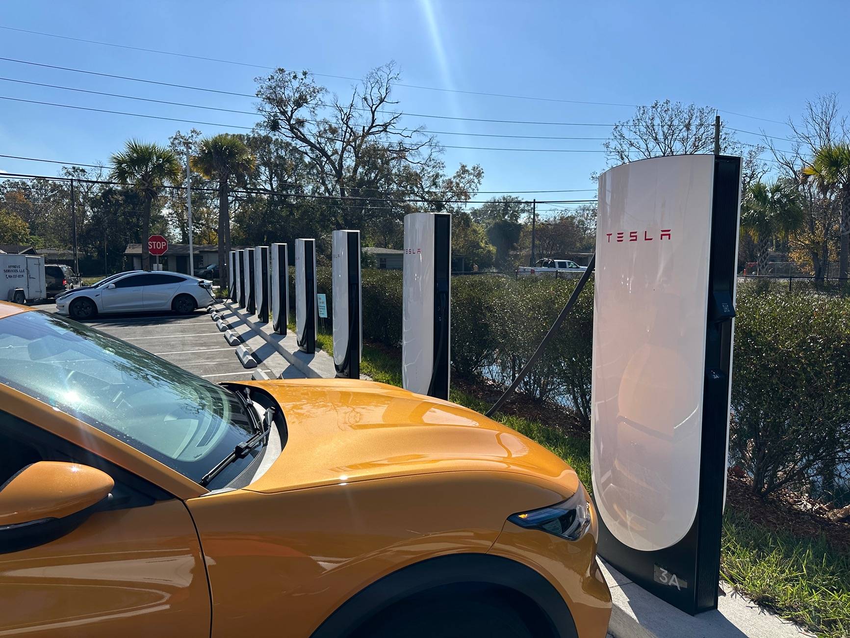

I used one last Thursday in Jacksonville, FL that opened about 3 weeks ago. I normally use the V3 station that is 5 miles from this V4 station when I’m in town, but I wanted to try a V4 for the 1st time.

If they're not marked by Tesla as compatible with non-Tesla, but it's a new station, they probably will be updated soon. There was a new supercharger near me that was not compatible immediately after it went online but was updated maybe a week or two later and is now compatible.

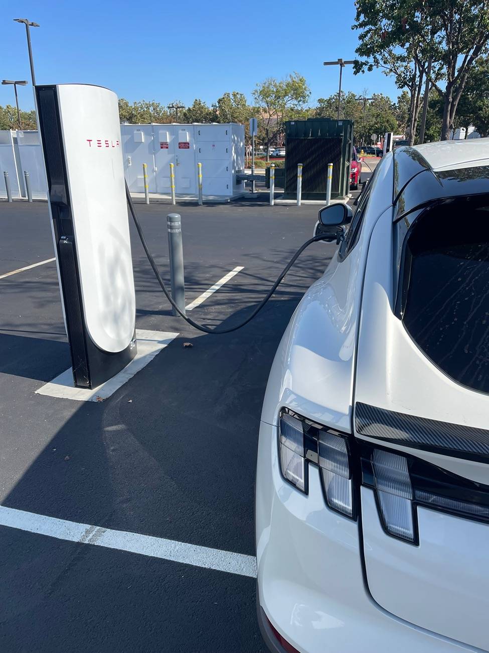

I’ve been using two different V4s for about 6 months, one was brand new. No issues with plug and charge save for one time it would not activate so I used the Tesla app to activate the charger which was nearly as quick. Most of the V4s I see here in NorCal are positioned between spots and not at the top/curb of the spot.

Sorry folks, those aren't v4 chargers. They are v3.5s. You can see the v3 power cabinets in some of the pictures.
There are no v4s installed in the US yet. v3.5 = v4 dispenser + v3 power cabinet.
For those of us with Ford EVs, v3.5 is all we need. The v4 cabinet provides higher power needed for 800v architecture BEVs.
