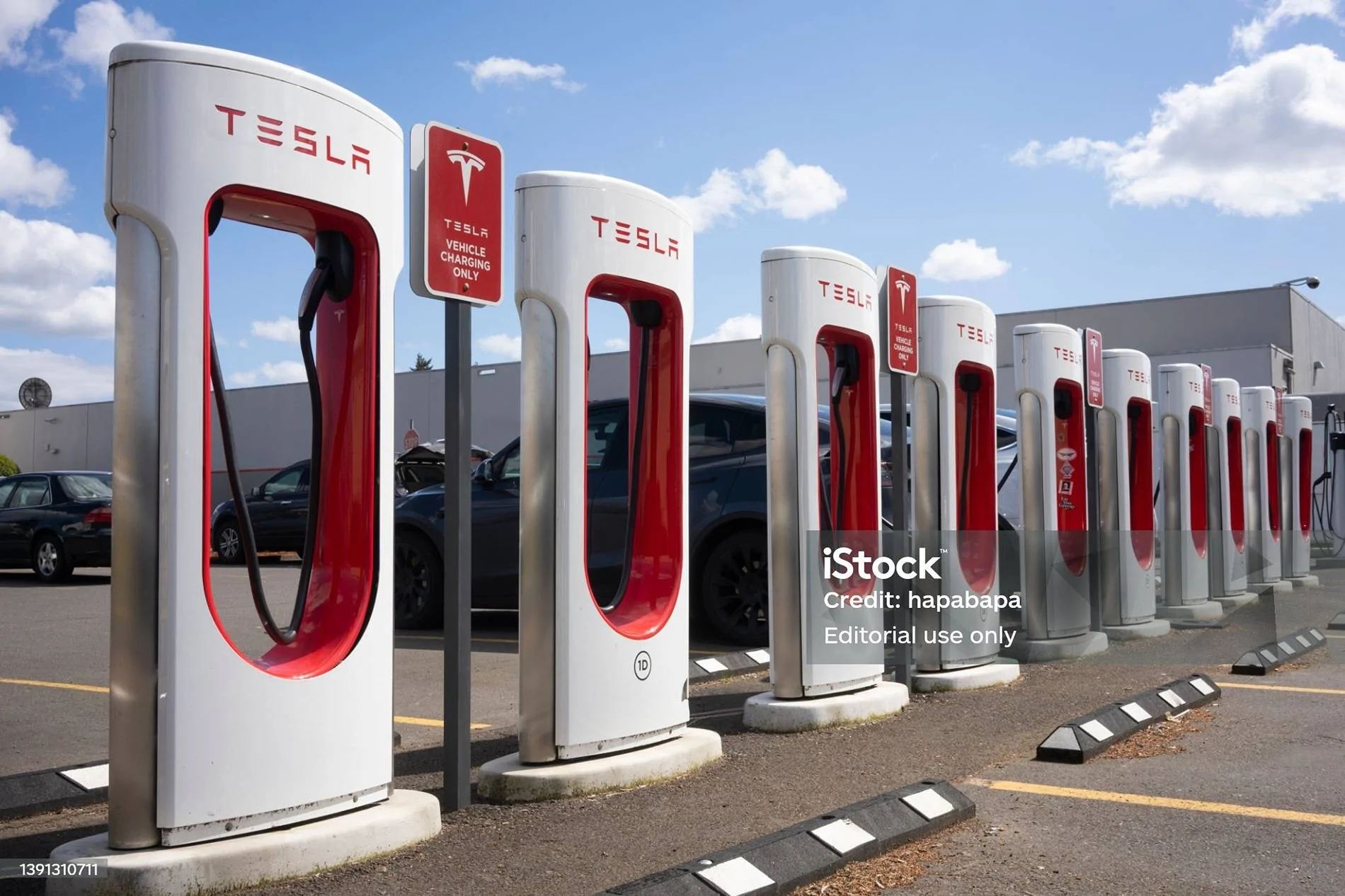

Now I've watched the vids of using the adapter so I'm comfortable with the mechanics, but I have questions about positioning. I went to our local tesla station which has two chargers per parking slot (this site is like the pic in that one space in front and one space behind chargers)>
To me it looks like if I pull into a space I should use the one on the left of the space? Do I pull as far forward and far to the left as I can? The station I went to was full so I couldn't really experiment. This pic is the type of charger setup of our local station.

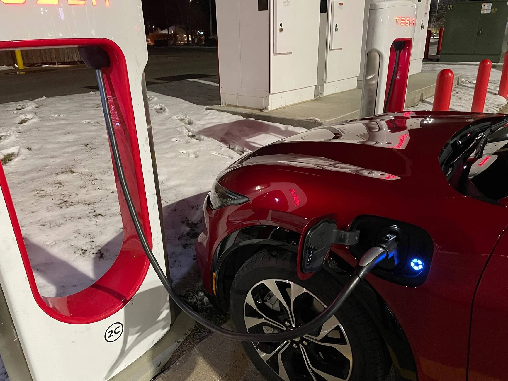

This is the best parking setup, try to match the LF corner of your Mach-E to the corner of the Supercharger post as close as you can without touching. When you pull in to a Supercharger, completely ignore the lines on the ground and instead just focus on the Supercharger post as your visual reference. Your nose will stick out past the post on the right side. In the back-to-back arrangement shown, you may come very close to hitting the Supercharger post for the opposite side because you have to pull up pretty far.
Here’s mine:
