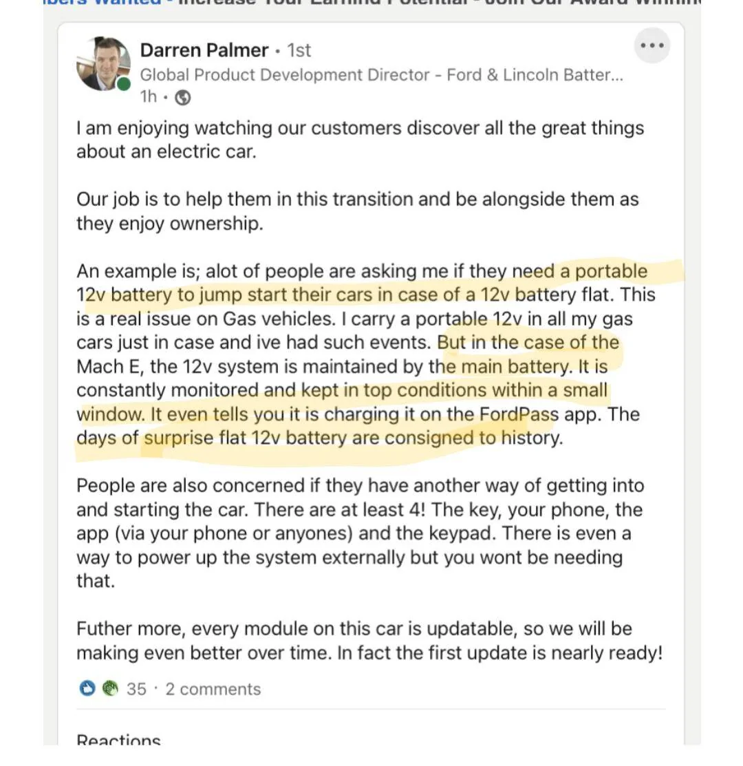

Tweet at Daren Palmer. He is the one that said MME will not have 12 volt battery issues ?. Kind of ironic. Sorry you are dealing with this!
His quote "the days of surprise flat 12 volt batteries are consigned to history"
Who the hell carrys 12V battery on his ice car!
This guy is a total bs.
Lots of people carry a 12V “jump box.” ??
Darren Palmer is in charge of the Mach-E program, so… ?‍♂??
