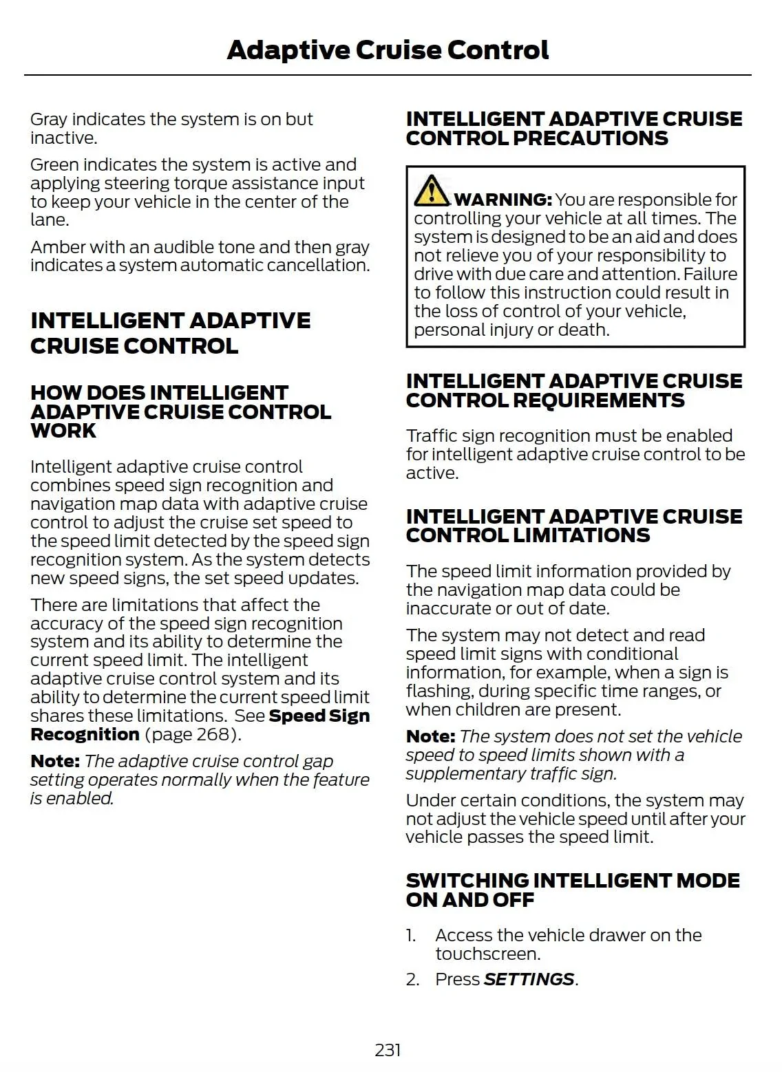

You likely have Speed Sign Recognition in Adaptive Cruise Control turned on. While in theory that's a useful feature, in reality is too often leads to unexpected results. Most end up turning to off...
I still use this feature and find it worth the hassles. However, on some roads I just have to be ready to respond often. A classic example is I-95 north of Baltimore. When driving in the standard lanes, the speed limit is 55. The wall-separated toll lanes have a speed limit of 65. Signs for each portion are located on both the left and right sides of the lanes, meaning the wall between the two will have alternating 65 and 55 signs.
