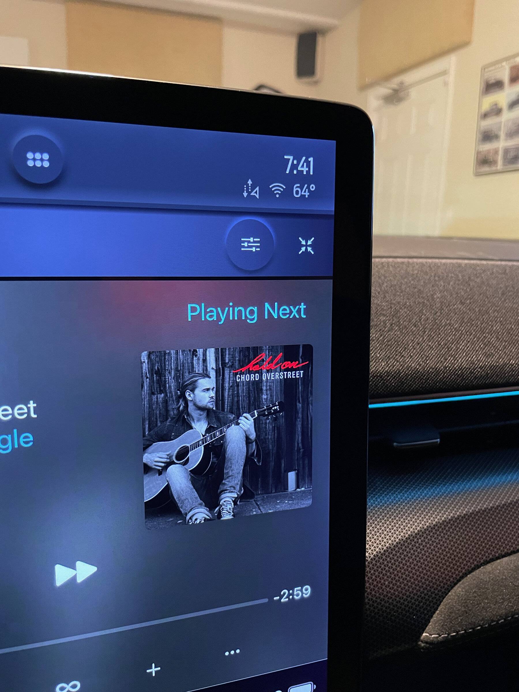

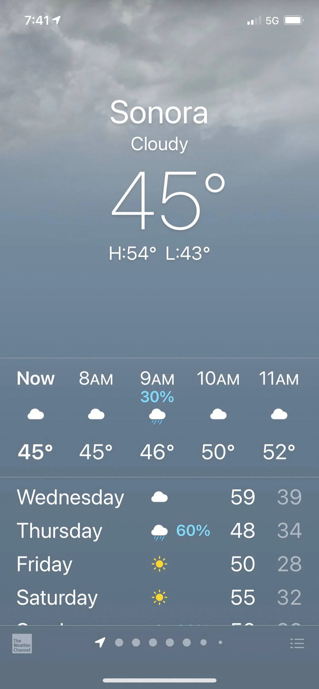

Chris, I don't understand how your car can show the outside temp that is on your phone when the two don't communicate with each other. Not that I don't believe you but this is very strange.
I just went out in my garage where it is 64 and my phone shows 45 temp outside (which it is). I only use PAAK so no key fob is present. Got in, started the car and it shows 64, the temp in the garage not the outdoor temp. I don't know what to tell you.
Okay, so I just went down to the garage on lunch to see. Only took my phone. Thermometer in the garage reads 52, its 31 out. and the car reads.... 52, so im just full of it I guess... lol, not the first time i have proven myself wrong.
