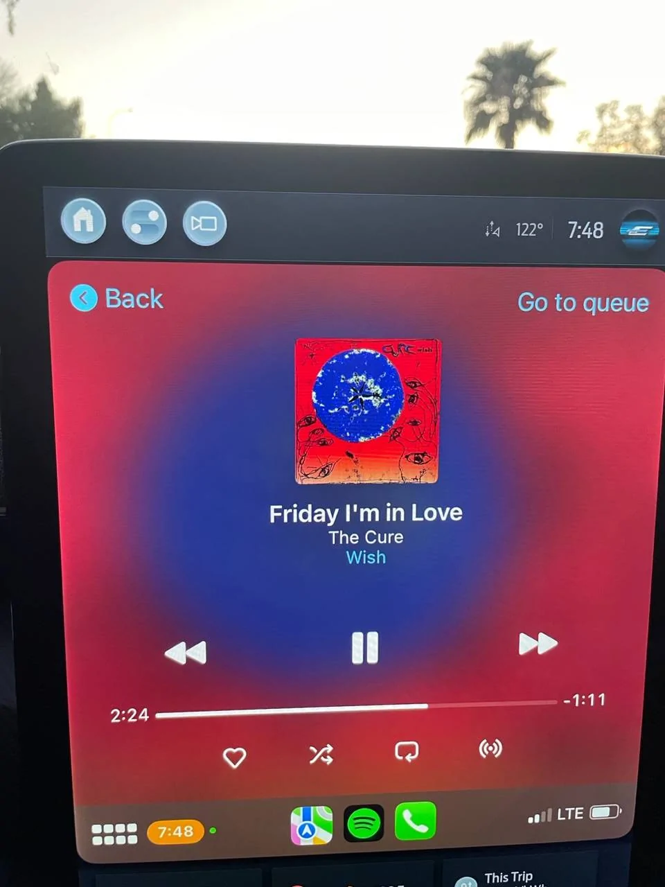

Yup. No reason to worry.
'We Arizonans' have you beat by a lot and the cars are fine.
Ford Mustang Mach-E Temperature too high - Plug in IMG_4737
