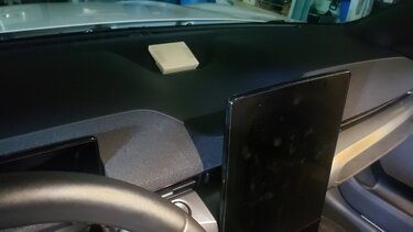

I put mine in the same place I think: on the dash behind the screen where the dash dips down. It works fine for me there. It tends to slide around so it is not a permanent spot, but for me that is fine because I don't do a lot of toll roads and I don't want to mount it to the windshield anyway.
Get some rubber drawer liner the open hole type it sticks.
Oh yeah I don't stick mine on. I only put it there when I cross a tollgate.
