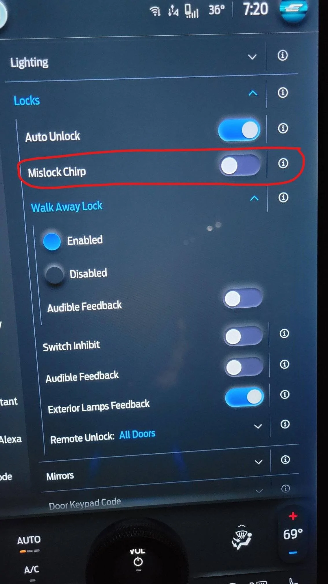

you causally close your trunk just to make grandma walking in front of your car suffer a heart attack from the double honk.
Can't you just shutoff off the "Mislock Chirp" setting to eliminate the double honk? Whoever at Ford thought a double honk was a good idea didn't think through the real world implications of that freaking honk going off unexpectedly. A chirp would be one thing - that honk risks the health of old people near these cars and risks my marital status with my wife who was still sleeping in the room right above the garage... Thanks, Ford honk designer.

Yes, it can be disabled with FORscan.
The "Mislock chirp" I am talking about can be disabled from the settings menu in the car. See attached picture.
