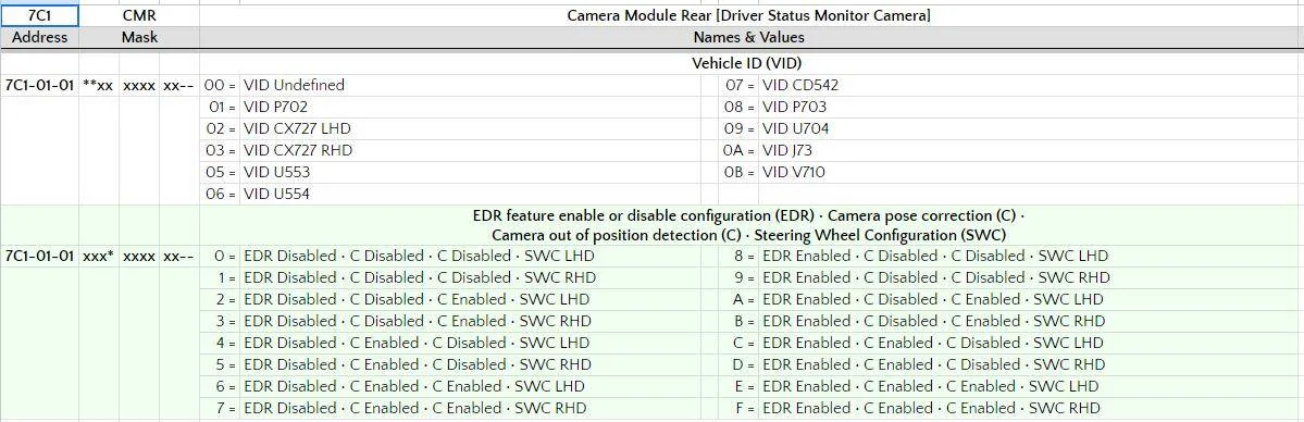

Disable Nanny Camera, Disable Hands Free, Enable Hands-On LCA:
