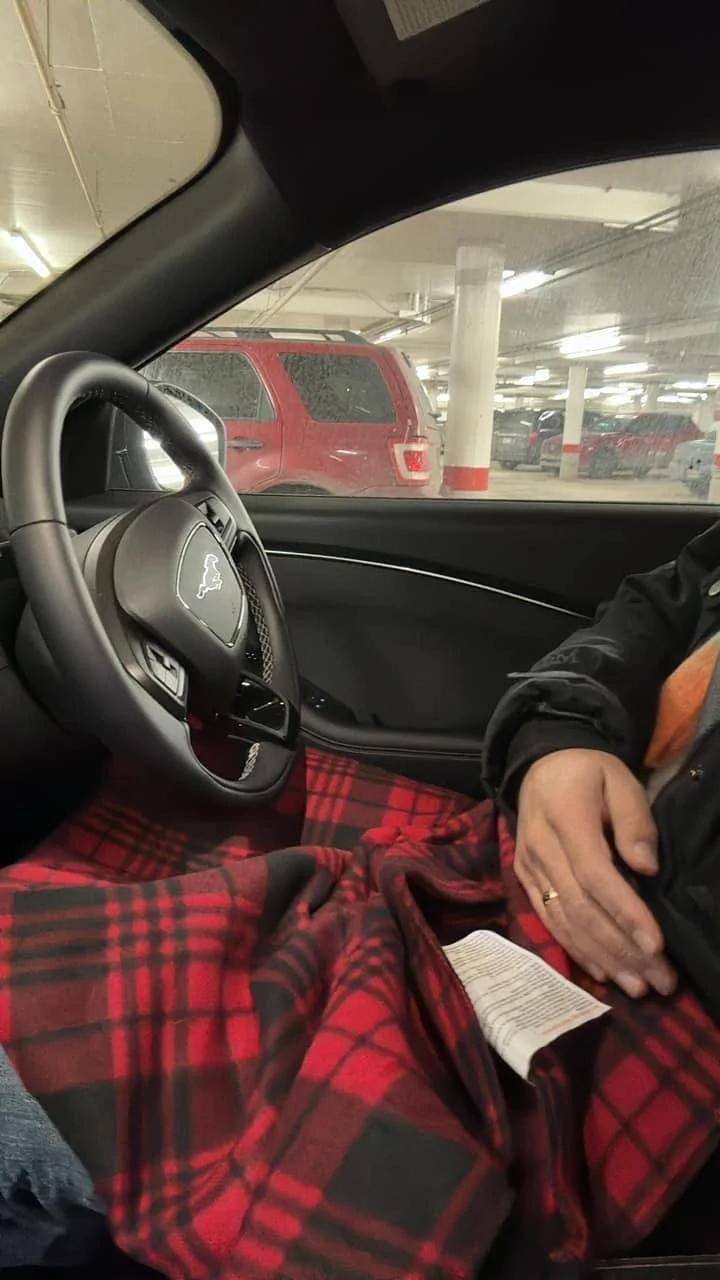

If the heater truly is underpowered in the Mach-E and Heat loss at highway from the battery plate is hard to overcome.....option an insulation plate for extremely cold climates that gets bolted on for winter.
A lot cheaper and easier is to buy a 12V heated blanked at Canadian Tire and drape it over the laps of the driver and passenger. Buy another one for the back seat if you have passengers back there. They are $Cad49 each at Canadian Tire. Plus, you can use them as a regular blanket outside of the car.
If you put the insulation over the battery, instead of over the passengers, you can't take that insulation into the ski cabin, or take it with you when your friend is driving a different car and you're a passenger. Plus the Can Tire one is a really nice red plaid that looks pretty sweet with the GT interior trim. I doubt they make a battery insulation plate in red plaid.
