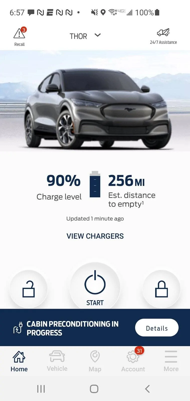

Precondition occurred outside the charge schedule. I did not have the option turned on to allow departure times off plug.
Interestingly it says Precondition cabin in Process when looking at FordPass. I guess "Preparing for Drive" is another message and might mean the battery is being conditioned separate from the cabin?
