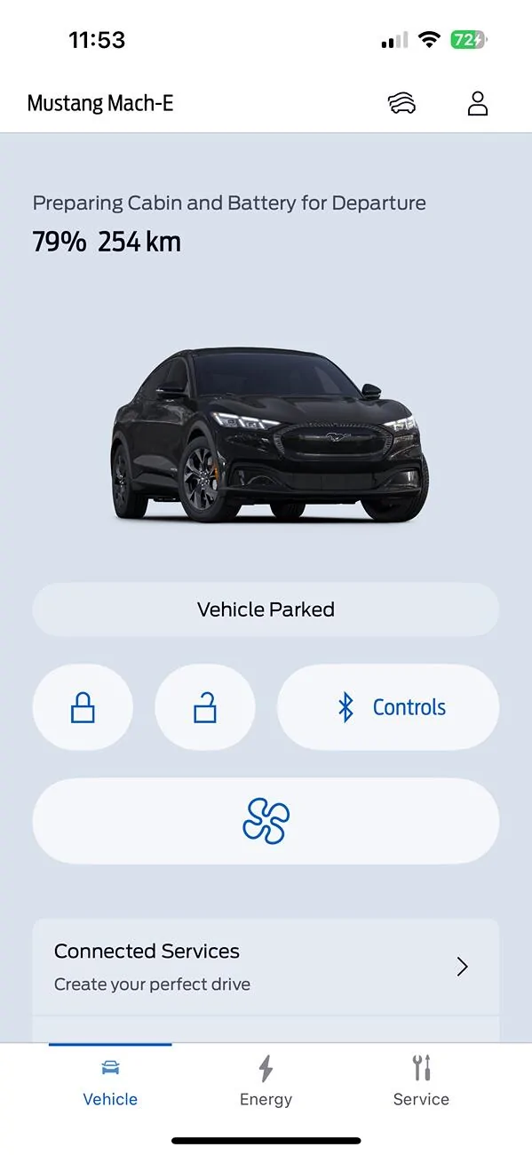

This is what I was trying to say, at the top it tells you if it’s only doing the cabin or the battery as well.
I had a scheduled departure for 12:30. today. By 11:53 is was already working on the battery.
for context my mme is parked in my garage kept at around 8c
it’s currently -12c outdoors though.
I also keep it locked to 80% and plug in everytime I get home. (I do a 100% around once every 2 weeks.
