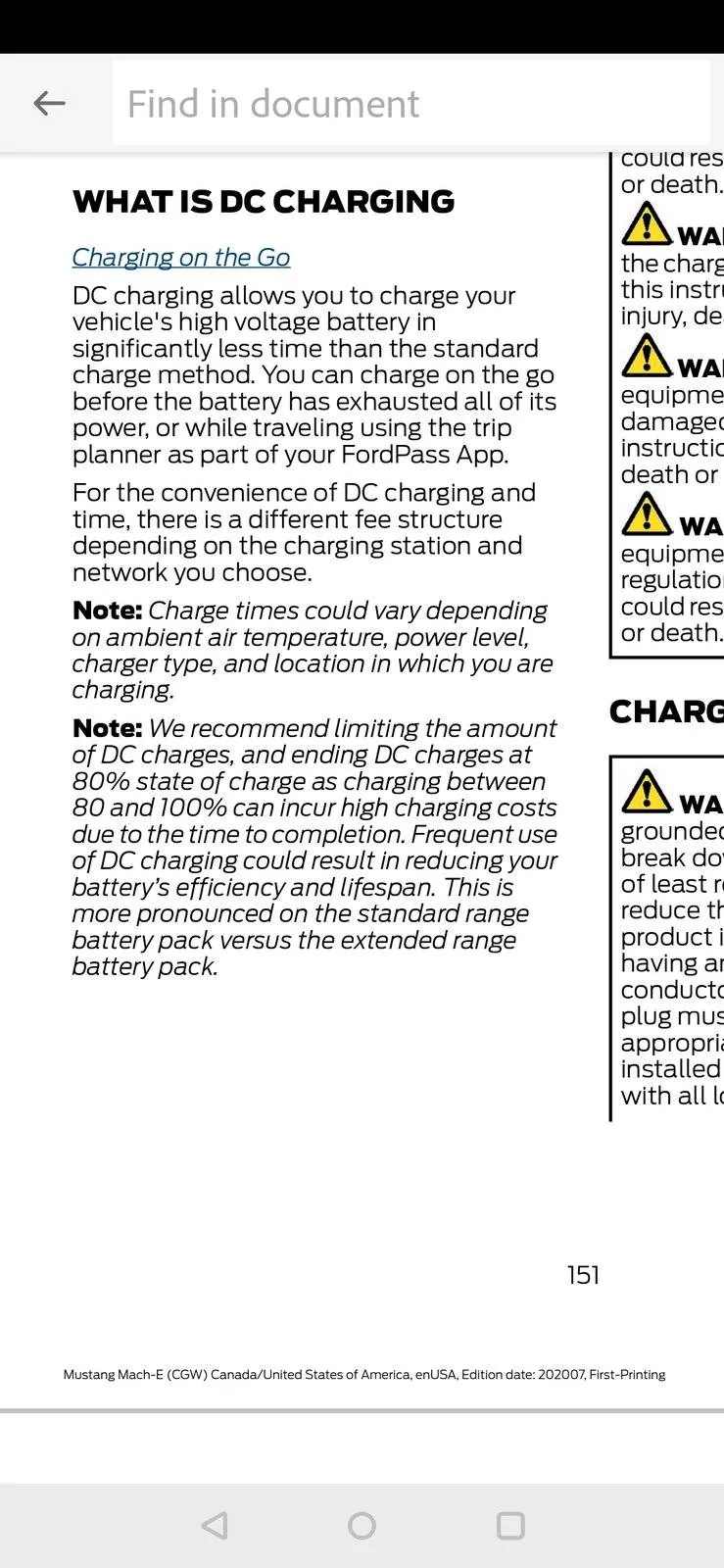

I've been reading the manual in preparation of picking up my car any day now. I've seen many people post similar statements on this forum, but cannot find the 90% recommendation in the manual despite reading the entire charging section.
In fact, the only reason Ford recommends stopping at 80% when using DCFC is to save money and time as charging slows down beyond 80%.
Ford Mustang Mach-E Unplug after charging? Screenshot_20210604-114340
It's possible I'm reading too fast to find the 90% recommendation. If so, can you kindly site the page number or online location of the recommendation?

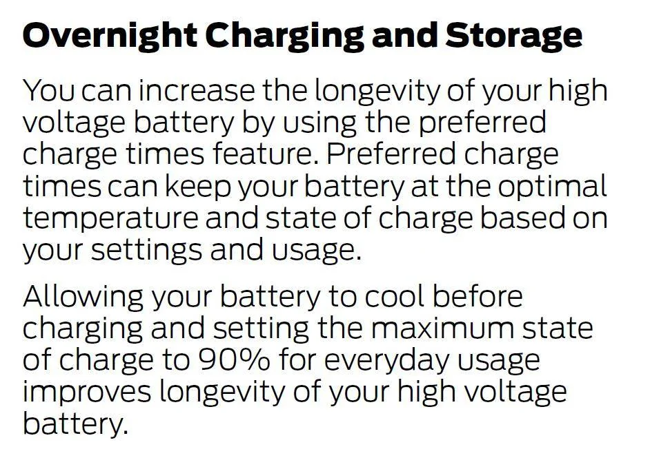

Right here, page 149:

Thanks... I'll be setting up a maximum charge to 90% as soon as I get my car.
On a similar topic, that paragraph recommends letting the car cool first. Is there an easy way to set up a delay without programming a specific start time. For instance, can I tell the car to wait 20 minutes before charging when I plug it in at home?
My electricity rates don't fluctuate based on peak usage times like in some places, so I'd rather it just charge any time of day when plugged in after a brief cooling period. As opposed to having it charge every night between specific times.
Also, I alternate between working days and nights every few days, so it would not be possible to charge on a set schedule.

There's no easy way to set up a delay and I don't have TOD electrical rates either. My Leaf can be programmed to start charging at a particular time or to end charging at a particular time. We set it up to end by 0800. Unfortunately the Mach E only has start times but you can set up two periods per day. I wish Ford had given us more options for this.

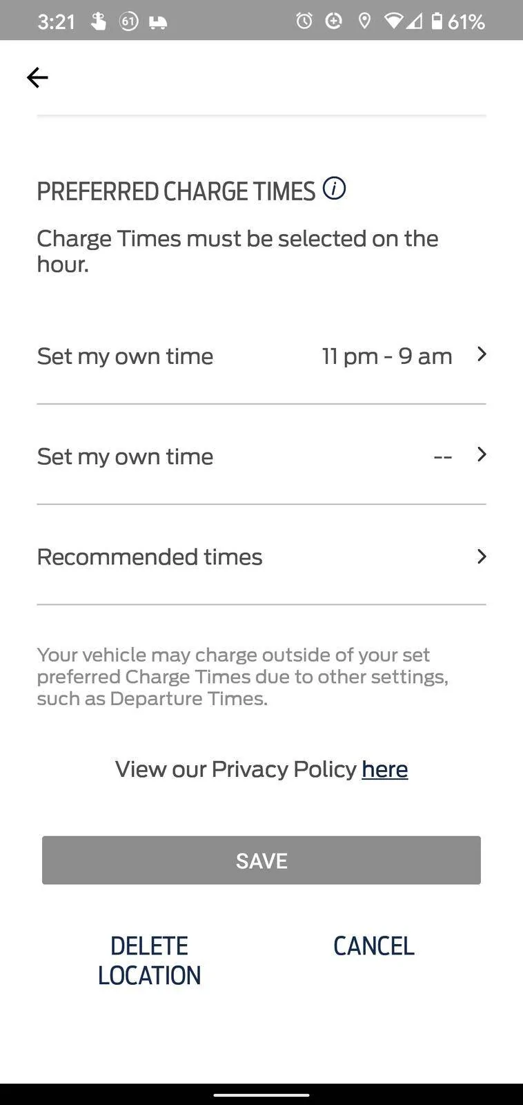

It has end times too.
But both start and end have to be set.
I don't have the tou plan but have my set to the times in the tou available for me. I figure that's best for grid and it's cooler at night.

SRP. I set my end time later than their TOU so I don't get messages about having to charge outside my preferred time due to the precondition settings. It's always charged before hand anyway.
I have solar and the tou plans don't make sense compared to my current netmetering.

Some EVSE models have a delay feature. Siemens VersiCharge comes to mind. I am sure there are others.
If you set a charge schedule for when you are sleeping then the battery will cool down prior to that time. If ambient temps are so hot that your battery actually warms up while parked (such as my area), then the car will cool the battery as needed as long as you have it plugged in.
