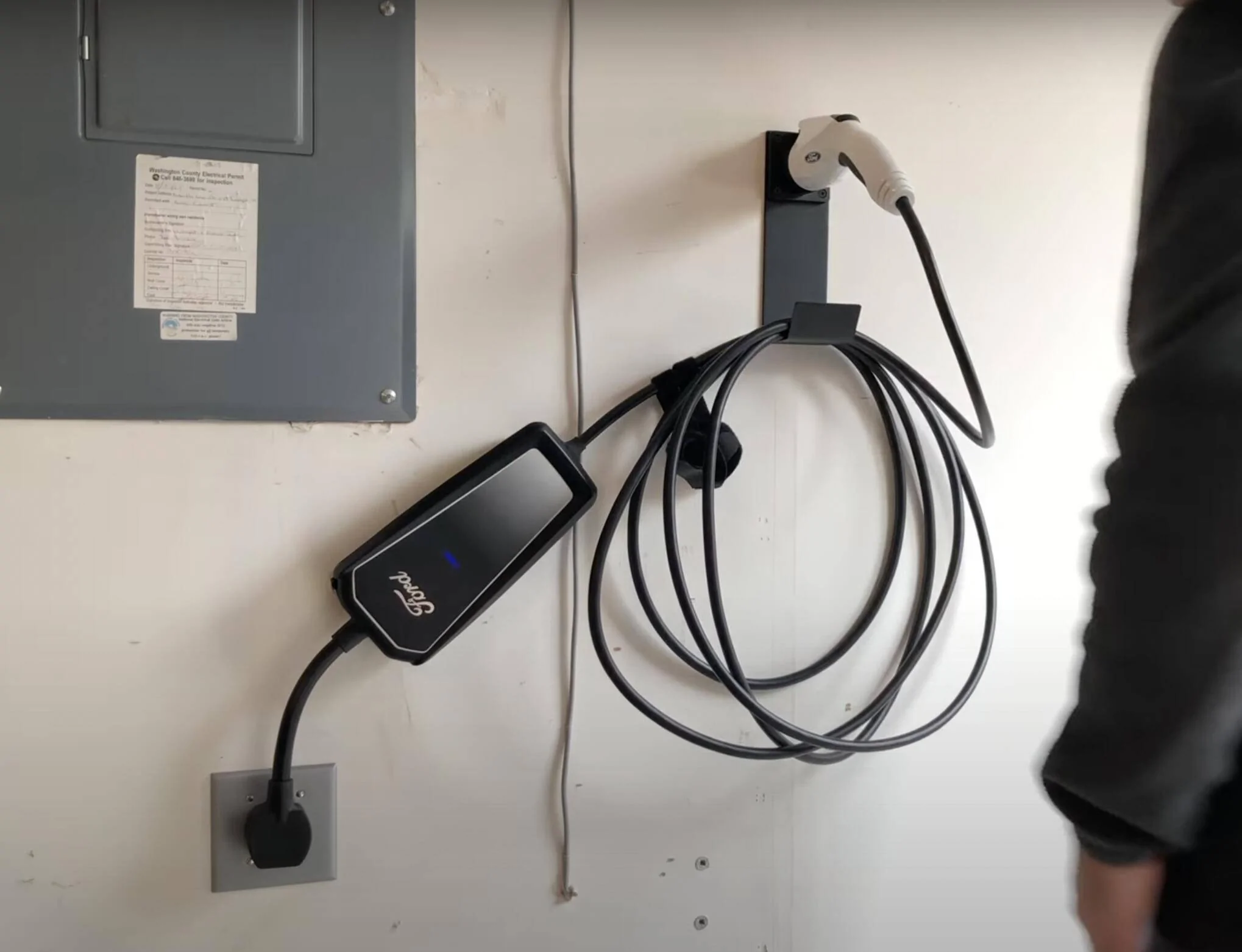

This is our setup...always plugged in (unless we take the EVSE off the wall mount for travel). To be fair, we only need to charge a couple times a month as we both work from home...more if we travel more (of course), but not daily and mostly not even weekly. We've owned the car for about 8 months now and haven't even hit 5k miles, but so far zero issues with our EVSE.
