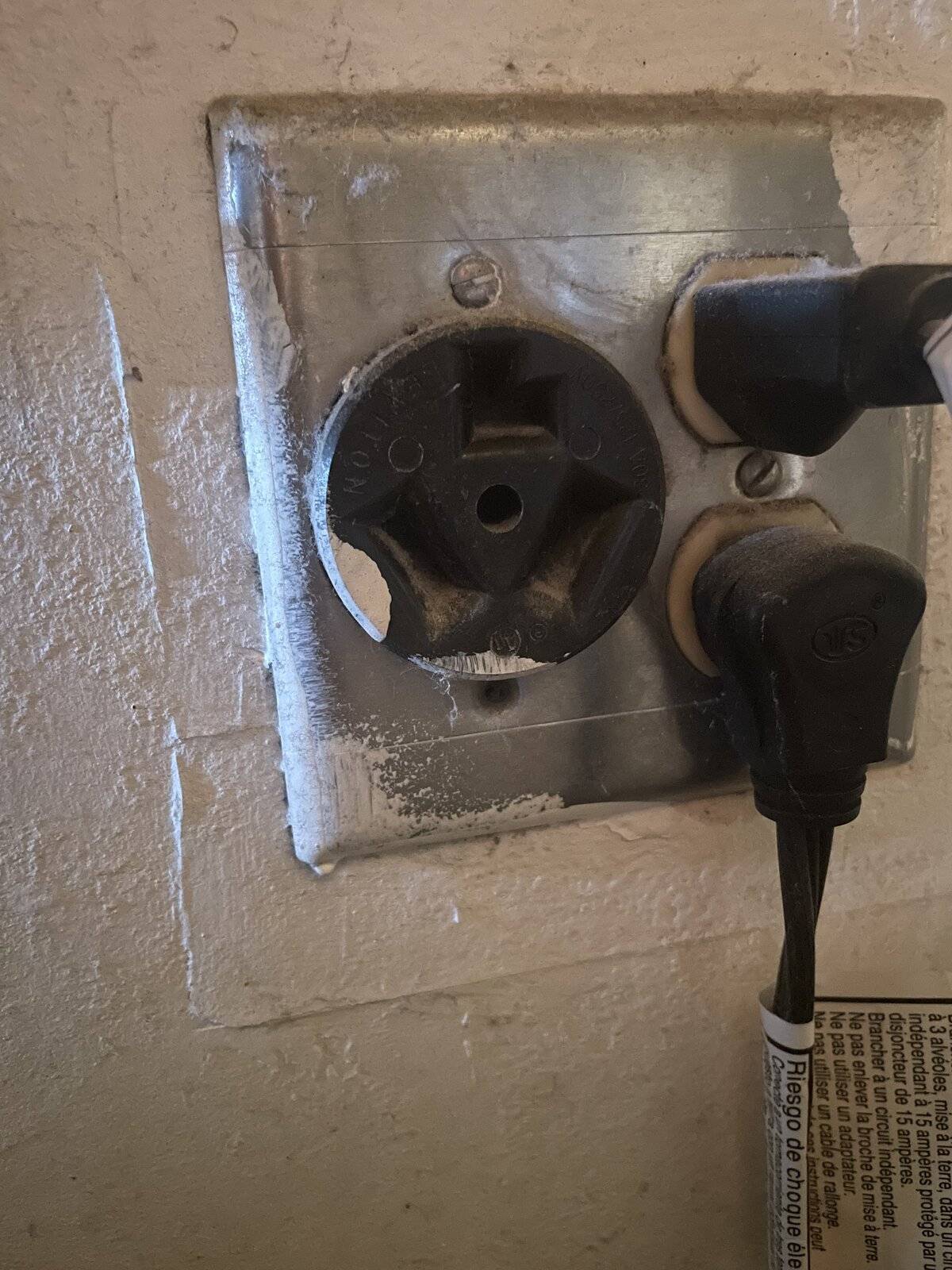

Actually, that picture is a 10-30, which is an older 3-prong dryer outlet.
Right, all he needed to do was replace the $10 outlet. But, it looks like he's just going to do it right and replace the whole circuit

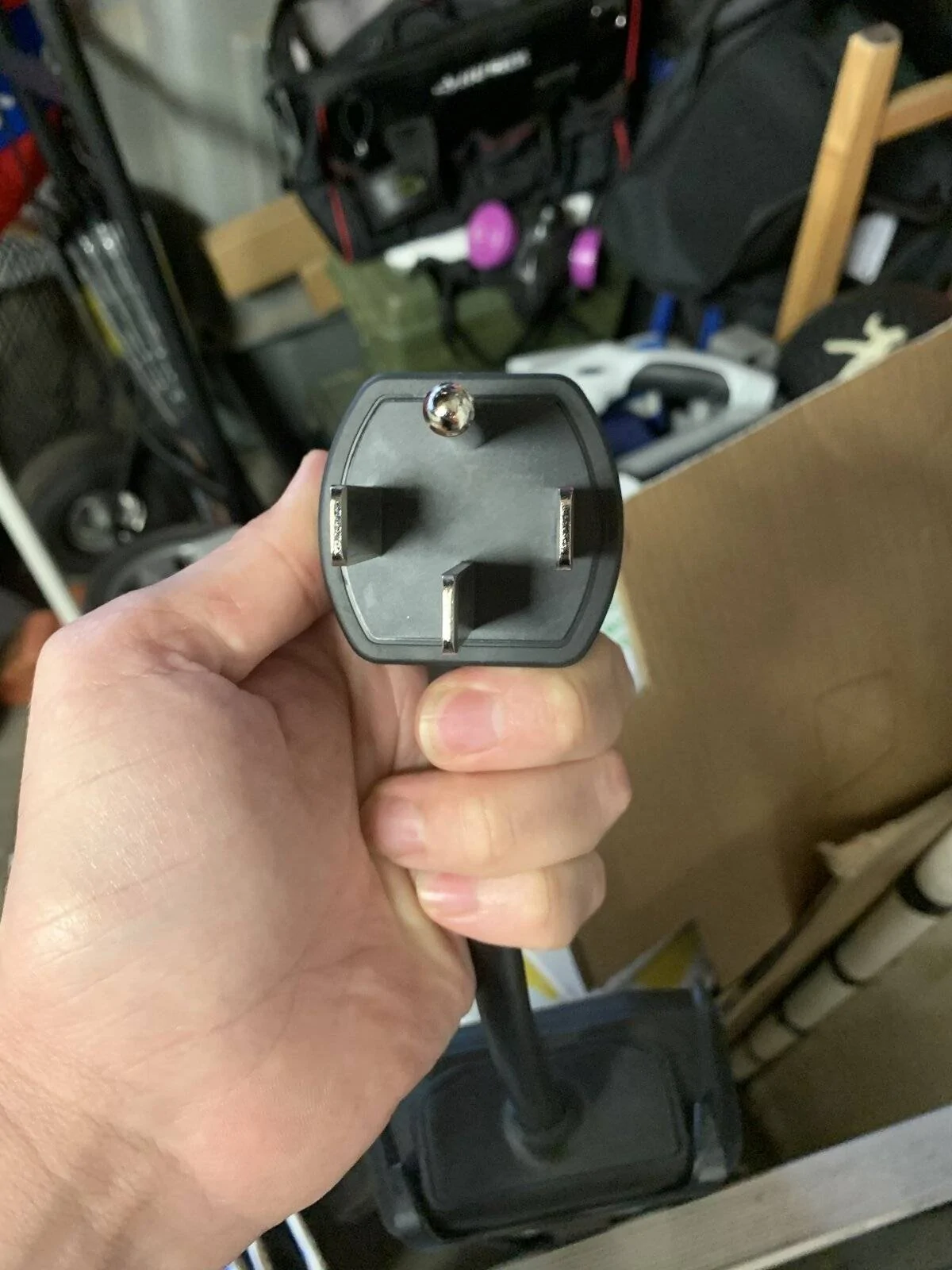

I have a picture of the Mach E 240v outlet.
yes, that is a 14-50 plug. He was saying your existing 30A outlet is not a 14-30 but is actually a 10-30

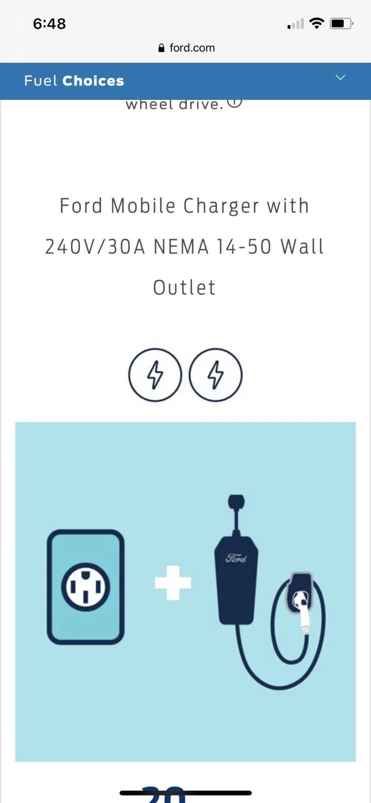

Awesome. Thank you! Am I missing something with the attached photo. It says 240v 30amp with a NEMA 14-50 wall outlet.
As others have pointed out, the Ford Mobile Charger comes with a NEMA 14-50 plug, so it needs to go into a NEMA 14-50 outlet. A NEMA 14-50 outlet needs to have wire rated for 50 A. That doesn't mean that what plugs into it needs to pull the max current. The Ford Mobile Charger only pulls 32 A. So you need a NEMA 14-50 outlet to physically plug it in, but it will only pull 32 A.
You cannot use an adapter to plug it into a dryer outlet because that's only rated to 30 A, so plugging it in with a physical adapter will result in the Ford Mobile Charger pulling 32 A and tripping the breaker. You can use the dryer outlet, but then you need a different EVSE that only pulls 24 A (80% of max rating of 30 A).
