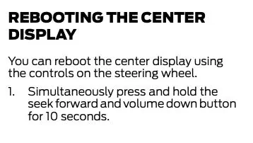

Your other option to resolve glitches is to reboot the Sync 4A screen:
Ford Mustang Mach-E Unusual behavior after attempted charge Screenshot 2025-06-27 at 5.11.20 PM
